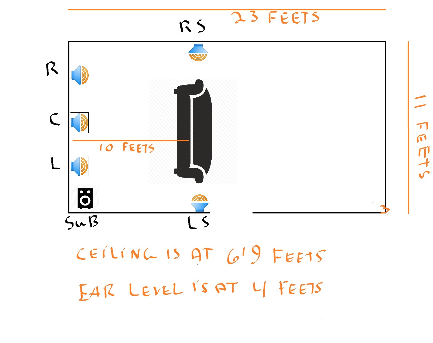

Hello Audiofriends from a french Canadian guy (english is a bit bad sorry) :)
I will like some insight on upgrading my home theater system. Should i go for 7.1 or stay 5.1. Should i upgrade to atmos, or should i upgrade my existing speaker for better one. i have include in this thread an image with some spec of my room.
i know i have some limitation with my room, so i dont know if i can accomodate a atmos system in ceiling (i dont want the bouncing speaker). Is 7.1 possible in my room and will it make a difference?
If i upgrade my speaker what should i be looking for so i can hear a big difference.
My budget is mid range.

thats a good idea but dont you think i might be a bit far from the tv? you would put 4 atmos speaker ?
Depends. How big is the display?
Yes I would go with 4 tops. Especially since you have enough room behind the LP. Too many times people do 7.x.x with a couch against the back wall. Don’t get it...
IMO, if you have to choose(which doesn’t seem to be the case) 5.1.4 is better than 7.1.x. Rear surrounds are icing on the cake but a well implemented 5ch base layer is ultimately more important. FWIW mine is 7.3.4.
