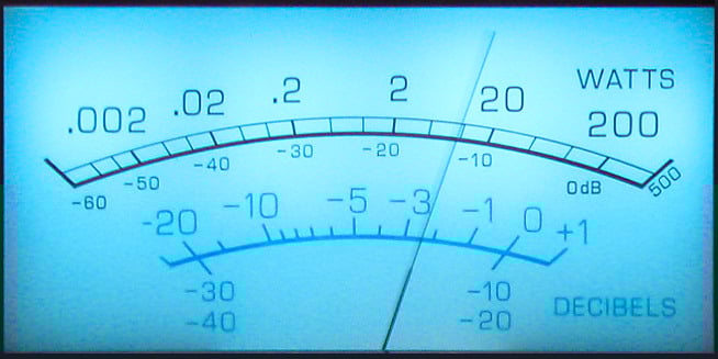

A 4 dB increase is not much louder. It takes 9-10 dB for doubling the volume, about 10 times the amp power output.
The increase in perceived volume (loudness) depends on the frequency, and for sub woofers a 4 dB increase is indeed quite audible.

I don't know where they got their info from. Just have a look a the following link. Nowhere they talk about difference of loudness perception with low frequencies:
Your linked article assumes that perceived loudness is uniform for all frequencies, though the Audioholics article I linked to says that is not so. In the section "A Word on Human Perception of Loudness" you'll find references.

4dB is a lot in subwoofers. That is a doubling of power. Perceptually it is likely also something close to a doubling.

Well that’s kinda what I was saying above, but verdinut linked something else. I said 3db somewhere above, and I totally agree. 4db is considerable.
