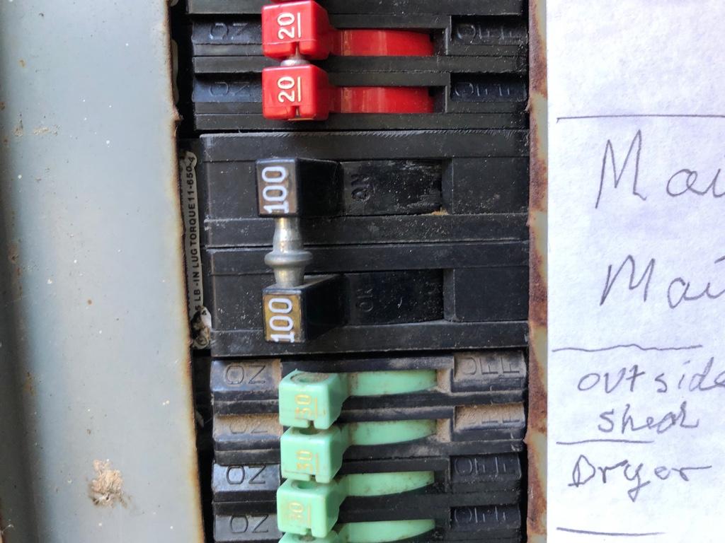

I am at the main panel. How to identify surge protection?
C
Coolravicool
How do I identify dual post 100 Aplus

is there a little box attached near or in the panel, with wires going to the household main?
for example:
C
Coolravicool
I don’t see such a box.
ryanosaur
ryanosaur
There is likely a dual-post breaker, likely at the top or bottom of your panel.
Dual post will have two switches. The switches are all numbered for the rated amperage.
ryanosaur
ryanosaur
My expectation is that you would have been told if you had one.
How old is your home?
When did you move in?

I see a dual post Type 10kA 120/240 V

This is what mine looks like:

How do you know the 100 switch is for surge?
C
Coolravicool
Mine had 40 mentioned on it. Not 100.
ryanosaur
ryanosaur
It's not, but whole home surge will be attached to that.
I don't have one, whole house surge.
But like in that photo of the siemens product, it would be wired to the House main. I didn't take off the second cover panel.
Here's a different product showing installation outside of the panel:
Just looks like breakers, probably need to take the box off. Ryan beat me to a variety of the way they might look....
