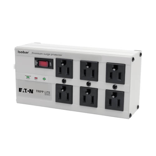

Just buy the Tripp Lite Isobar 6.
If your that scared buy two and plug one into the other.
