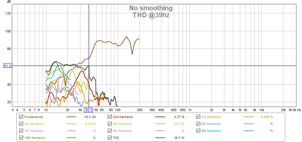

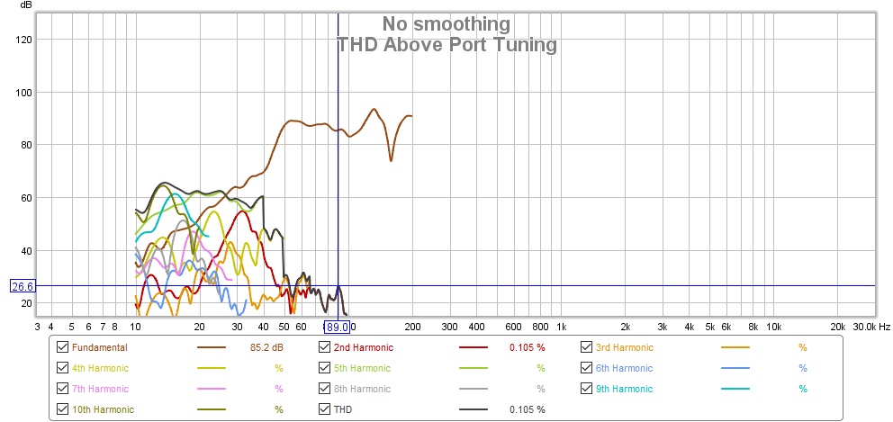

Not in dynamic range. If you want to get reference level playback out of a bookshelf speaker, you’re gonna have to go with Klipsch. The HSU might be capable of it as well, but I have no direct experience with it.
Reference level playback is a big task for any speaker. I haven’t tried it with the jbl, but I can say from my own experience and measurements that the 150m is entirely capable of distortion free playback at reference levels from 60hz and above in a medium sized room. All of these speakers, including the Klipsch, will need a sub and need to be crossed over to play back at higher levels. As you can see from the graph, below ~47hz, distortion (and excursion) increases rapidly.
That’s only 85dB, 20dB below reference level. With no sub connected, an avr will simply send the full +10dB LFE signal to the fronts, which could cause them to bottom out and even blow.
