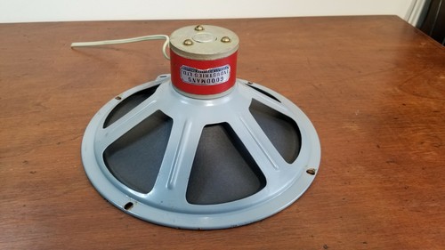

That is what I had found listed on eBay and it's seems to be a genuine Goodmans driver. However, I didn't look for any confirmation of Westrex being related to that company. I strongly doubt that connection:
That is what I had found listed on eBay and it's seems to be a genuime Goodmans driver. However, I didn't look for any confirmation of Westrex being related to that company. I strongly doubt that connection:
That is an early Goodmans Axiette. However, after Ted Jordan became their engineer it quickly became a very different and much better driver. That poster is mistaken. Westrex had no connection with that driver.
I used that speaker in some of my early builds.
