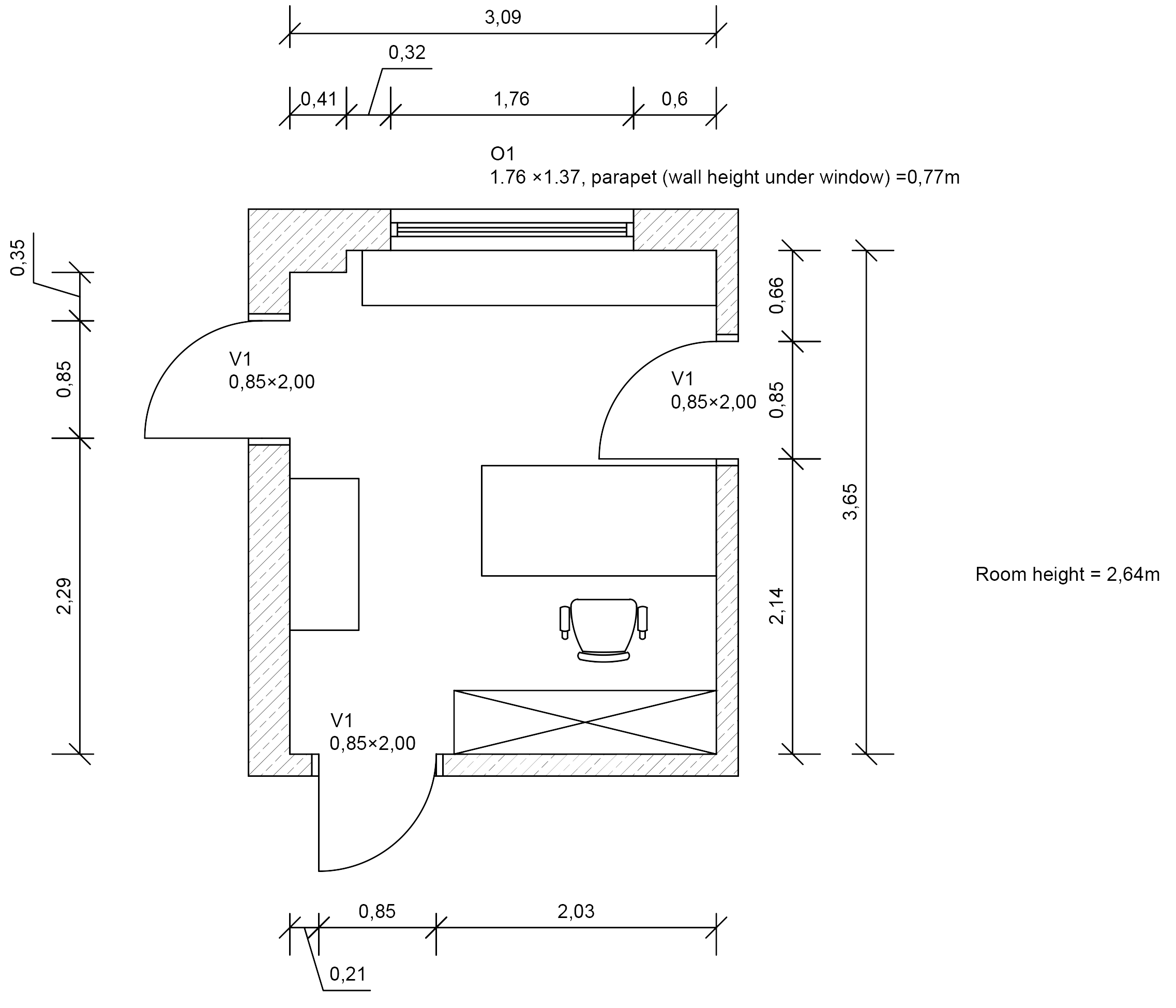

So after a couple days of research I narrowed my options for active speakers to these 4.
JBL LSR305 vs 305p mkII vs Mackie MR524 vs Presonus Eris E5
Its for my dads office. Its not a big room, 3,09x3,65m (10,1x12ft for you rebels out there). Height is 2,64m (8,7ft).
The thing that makes scratch my head the most is the bass port. While the JBL and Mackies are rear ported, the Eris have a front port. And I dont know which one would perform better, given the odd listening position. Behind the seat is a tall bookshelf, extending almost to the ceiling.
So rear port too far away from back wall, and front port is too close to front wall..
He likes bass, and has a bit of a hearing problem (severe dip at 4khz, from what I understand). And the Mackies do have a dip around that region..
They will be used only for listening to music, and I want something that does not cause ear fatigue, although I was wondering, given his hearing condition, if I should intentionally choose something with emphasis on HF?

Three "rebellious" questions .
1) Which is the front wall?
2) Is the chair & desk in the diagram where he will be?
3) Where do you intend to put the speakers?

Thank you for the reply! :D
Here is the updated floorplan.
Yes, sadly there are no other options for the desk and chair to be.

Solist
This could be another option, but I doubt he will go for it.
The bookshelf has a cabinet on the bottom, and this would make it inaccessible.
If he plans to keep the door in front of the desk open, I think it will be a problem :)

I don't think you'll have any issues with rear ported unless like highfigh mentioned the door will always be open. Even at that I'm not so sure rear ported will be that big an issue. As far as powered speakers go the JBLs get lots of love and would likely be my choice.
I was kidding. I posted that before I saw the second diagram, showing the speakers on the desk.

A port only needs a few inches to breathe effectively, so either port configuration will work for office option diagram 2 or 3.
He can always close the door if it bothers him in option 2.

Thank you for the replies!
Yes, the door will be closed, no worries about that :D
