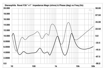

Your speakers do seem to be honestly rated at 87 dB. That's not inefficient. I'd be willing to bet that most speakers claiming a 90 dB or more sensitivity are fudging their ratings to the point of being downright dishonest.
Stereophile shows an impedance curve in their review of the F30s. Their estimated sensitivity is the same as what Revel claims. Their impedance curve suggests the F30 are not a difficult load.
Stereophile shows an impedance curve in their review of the F30s. They estimated sensitivity is the same as what Revel claimed. Their impedance curve impedance curve suggests the F30 are not a difficult load.

I think you need to be careful. They seem nice speakers that measure well. I don't think they are high spl speakers and if you force the issue you will probably damage them.
The cross to the midrange is low at 220Hz. There is one small unit for the midrange, taking over where there is huge power in the music. A passive crossover at 220 Hz is highly likely to saturate at that crossover point and the mid almost certainly is in the thermal compression range and high distortion. If you go from 100 watts to 200 watts you will only gain 3db.
I don't know if it is your speakers or amp that are power limited, I suspect both.
That speaker is not a high powered design. It seems to be a speaker with good measurements for refined listening.
Generally to do what you want requires a full active design with electronic crossovers at least for the low crossover and two midrange units.
I would enjoy you speakers for what they are an not be tempted abuse of the speakers.
I do think what you are contemplating constitutes abuse of those speakers.

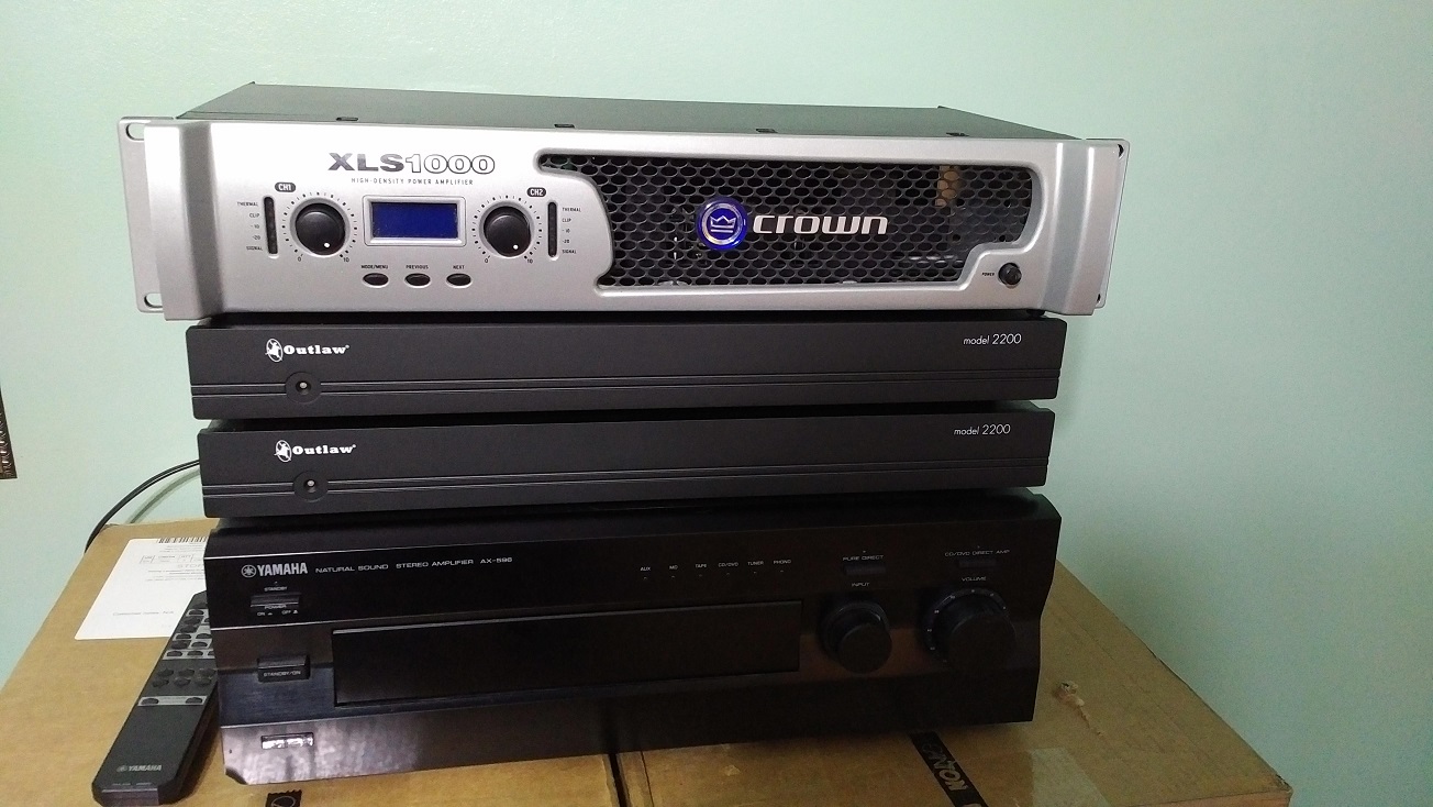

So yeah... first world problems. :rolleyes:
I've actually had the Crown amp since last week and have been incredibly impressed with it. They really do make you rethink what should and shouldn't be, as far as home amplifiers go. I've used it long enough to get a good grasp on what I like and don't like.
The Outlaws were totally impulse. I saw the pair on sale on ebay for a reasonable price, but was on the fence... until I read ebay had a 15% coupon running that day. They just arrived today. I won't have the house to myself until Wednesday or Thursday so a thorough evaluation will have to wait. In the meantime I will have to enjoy them at "domestic" volume. Heh, heh.
One thing for certain, my problem was without question a lack of headroom for transient and sustained peaks. With the XLS I listened specifically to songs that had passages that weren't resolving well (usually emphatic bass, but not always),and was blown away at the difference having the power in reserve made.
So the Yamaha will definitely be up for sale, and I have to choose between the dual monoblocks or the Crown. Fun times ahead! I will post my overall (subjective) impressions and decision in a few weeks after I've had quality time with these monsters.

I will post a summary of my time with these amps later, but here are my pros and cons. Sound-wise, my ears never told me that one sounded “better” than the others. The biggest issue was headroom, and how bass notes would suck all the Yamaha’s power away at volume. Both the Crown and the dual Outlaws solved that problem easily. You’ll notice the majority of my notes are aesthetic (except for power and thermals). The higher input sensitivity of the Crown and Outlaw weren’t an issue with the Xonar sound card, and I’m sure most preamps would do fine as well. I’ve read negative buyer reviews of people complaining that they “could barely hear” the XLS1000’s, and I’m certain in those cases they weren’t matching it with the right source. Always something to consider.
Yamaha AX-596
Pros:
Beautiful, “traditional” look
Solid build, long-term reliability
Allows bypassing tone controls
The best speaker wire terminals I’ve ever used
100wpc into 8 ohms is more than enough power for most situations
Cons:
100wpc is not enough power for my situation :confused:
Gets a bit warm after extended listening sessions at volume
Pricey when new
Crown XLS-1000
Pros:
Power, power, POWER!
Handles current peaks with aplomb
Never ran warm at all
Extremely impressive array of configuration options
Easy to follow, no-nonsense owner’s manual
Gain Level knobs have detents for precise balancing
Level and clipping indicators
Lightweight (you pay dollars per watt instead of dollars per pound)
Balanced and unbalanced inputs
Unreal value compared to “hi-fi” amplifiers
Cons:
The temptation is great to buy a second one and biamp with XOVER mode!
I keep staring at the level indicators (SQUIRREL!)
(All these below are attributed to its intended PA purpose, but still should be mentioned)
I have dust concerns with the fan and back-to-front airflow design
Function over form: it’s not a looker; “Plasticy” faceplate and controls may wrongfully imply cheapness to some
High input sensitivity may have to be taken into consideration if used with home audio sources (fixed with the gen 2 XLS series)
Outlaw 2200 dual monoblocks
Pros:
P.O.W.E.R. for days
Slim and unobtrusive; their looks hide their beastliness from the unwary
Soft, pleasant LED power/standby indicators
Run cooler than the Yamaha under extended load, even with more power
XLR and RCA inputs
Cons:
Power switch on rear of unit (would be a total pain with a large stack)
No gain level controls
Form over function: compared to the Crown, lacking the value quotient
Can’t match the Crown’s power efficiency; I can dim the lights in the room if I play loud enough
