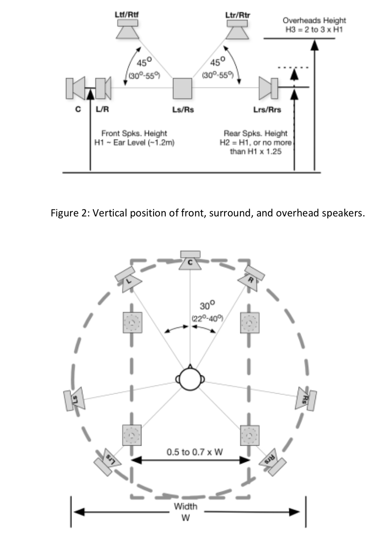

Is there a minimum separation figure for front and rear height speakers? For example, I'm planning to mount the rear surrounds a couple of feet above seated ear level. Add in the 7.5ish foot ceiling, and you have height speakers only a couple of feet above. At this point, I'm only weighing options. Thanks!
Are you doing rear surrounds ala 7.x.x? Or are you simply referring to regular surrounds in a 5.x.x system? I ask because there’s a difference and it helps to be talking about the same thing.
So, how did you decide a couple feet above? Convenience, or to get over peoples heads?
https://www.dolby.com/us/en/technologies/dolby-atmos/dolby-atmos-home-theater-installation-guidelines.pdf here’s the big guide.
Here’s an image showing the basic guidelines.
Basically it’s saying two to three times the height of the mains and surrounds for height speakers. Surrounds can be 1.25x the height of the mains. Mine are about 1.55x mains and are fine but my ceilings are taller than yours. In short I think you’ll be fine, but that’s pretty low ceiling height so personally, I’d go as close to ear height as I can.

Also, going back to the original post, connecting the surround speakers to the surround terminals(NOT the rear surround terminals) will make them much more active and give you better, or I should say correct surround sound.
B
bigkrazy155
I was talking 7.x.x. I had no idea that side elevation speakers were a thing, haha. I had been planning to raise the side and rear surrounds above ear level per the advice on one of the audioholics YouTube vids, but if low ceilings make true ear level more beneficial I can certainly mount them accordingly. Also, where do you get the diagrams? They are immensely helpful!

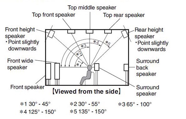

Normally I would tell you to lower the surrounds a little bit, but since you’re using 2 height speakers, I think that’ll work.
Also, do not install atmos speakers behind you unless you place front ones first. So yes, on the front wall, at about 8-9’ should be great, aimed at the LP.
Edit: Also, yes you can connect all 7 speakers to the denon. You’re not going to do any damage unless you have it cranked to painful levels.
Without knowing the context, I say someone just gave you bad advice as far as I can tell.

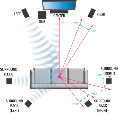

William, again thanx for the help ...
going thru some of the diagrams , i see my current use ...
to clarify, my L/R surrounds... are connected as such ...the rear surrounds ( Jamos ) are hung upside down on a shelf, built for them ...thus, those wires are in place , and i would rather replace those speakers (Jamo) put them up a little higher, on the rear wall
( there's actually a shelf that i could use 55" above ear level)
and avoid having to do the buried wires etc, on the front wall ...
however , if that placement was going to be significantly better , meaning much better effect, i'd do that dance ....
there are a few speakers ; Polk OWM 3 or OWM 5 / Cambridge minx min 12 or 22 that have been referenced in other spots, that have adjust-ability to them, angles etc which might do the trick ?!?
the variety of settings ...amp assignments ... etc . is what leaves me floundering a bit, and seems over my head = concern for doin damage to the system !
