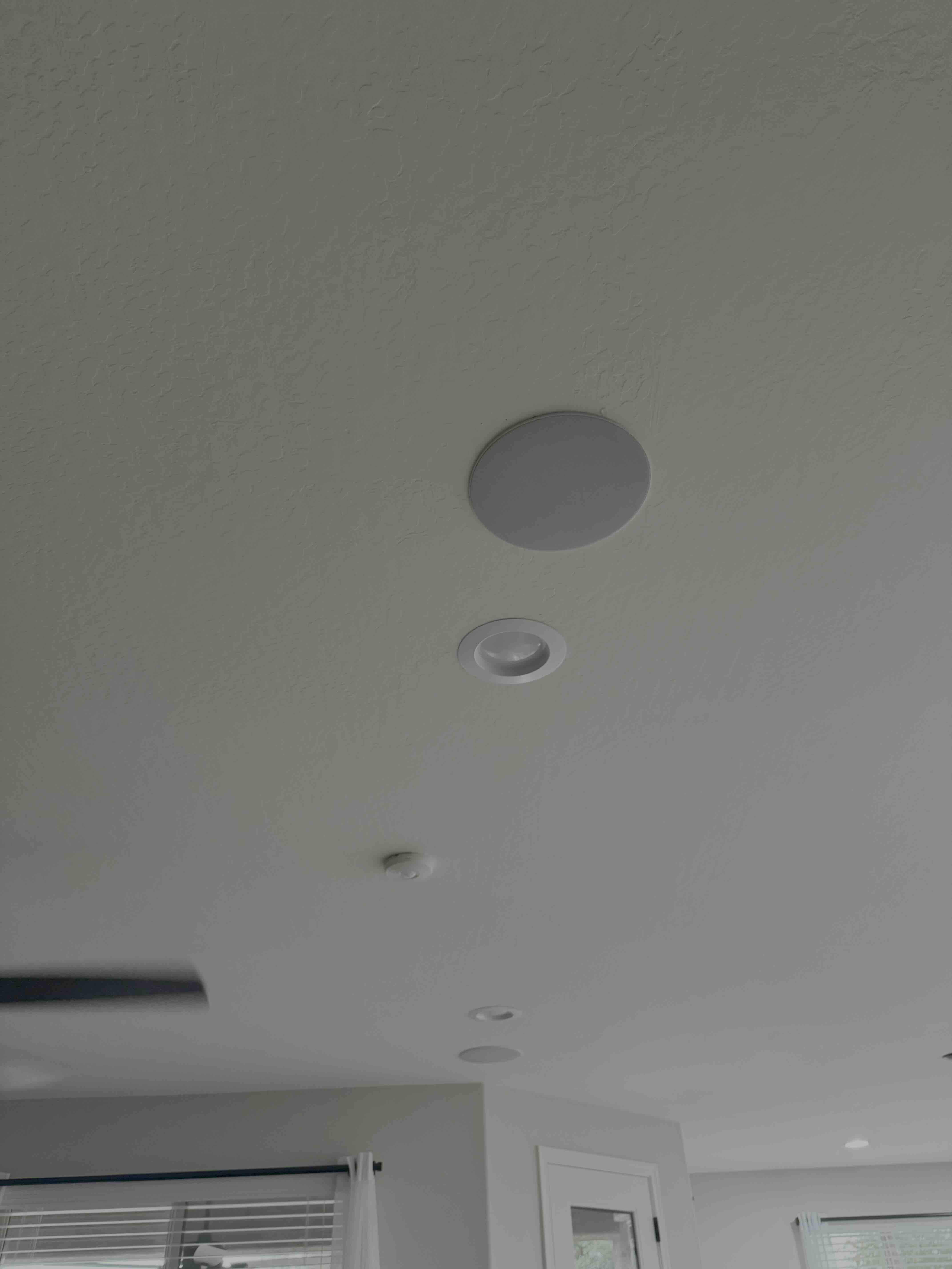

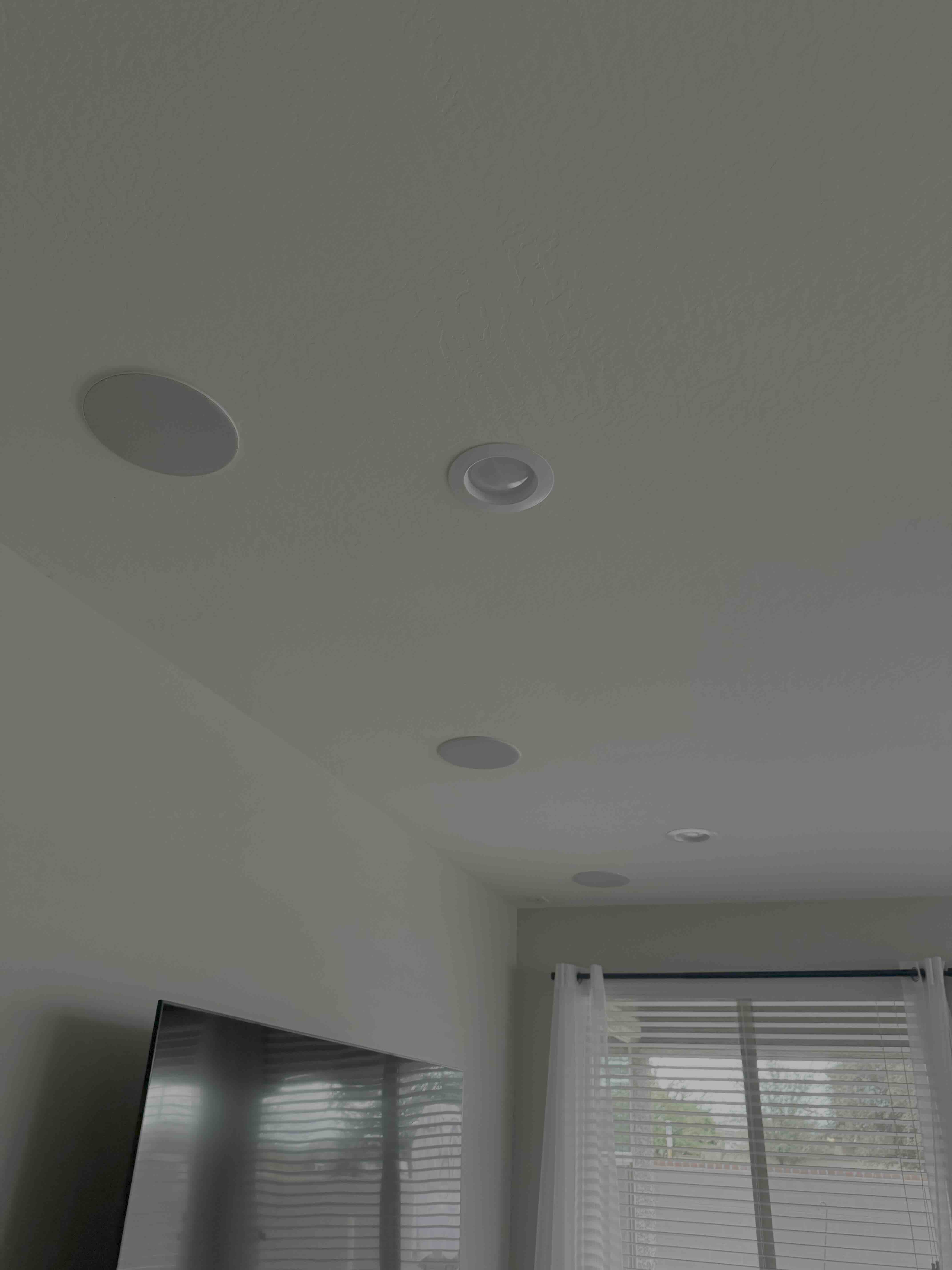

You are not making yourself clear. Exactly where are those speakers that are there now? I strongly suspect they are in the wrong place. Pictures would be helpful.
Hope the quality is good. You can see the front 3 speakers and back 2 speakers. I plan on adding more to include a sub. All other rooms, there are just 2 speakers. My main focus right now is making all other rooms independent with either a multiple channel system, like a Sonos Amp. Or they would be independent to each other and connect wall mounted bluetooth amps. like this (https://herdiotech.com/products/in-...3-gfLZlFBIlDI1D76U2-JRfQ8BSNq33m7EZ3OabQHolPi)
the pictures are of the living room that I would control with a dedicated AVR.
Just what I thought. Those speakers are totally useless and unacceptable as your base layer speakers. They just might be acceptable as the ceiling speakers in an Atmos system if they are if good enough quality. However usually those speakers are just bottom end junk and not good for anything.
