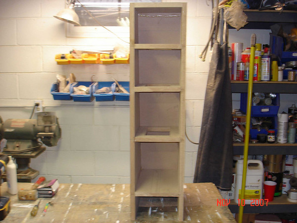

An enclosure that big without braces, will ring like a barrel.
Here is a view of a braced enclosure under construction.
I hope this helps.
