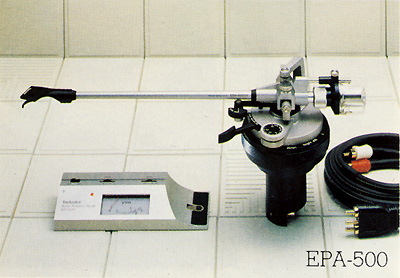

Now the big problem with all mechanical systems is resonance.
The most likely cause of your problem is resonance.
In this area the cartridge arm combo is crucial. Decca realized this back in 1958 and that is why all through the sixties the Decca ffs system was bases in integral cartridges and head shells.
Now low mass high compliance cartridges like the Shure and your AT cartridges, require low mass low inertia arms to get the arm cartridge resonances to fall into line.
I'm not sure which of the arms you have on your turntables. However most of the Technics direct drive turntables usually have the high mass S-shaped arms, designed for rough handling low compliance cartridges for commercial and DJ use.
There are Technics arms designed for low mass high compliance cartridges.
The SL 500 had interchangeable arm tubes to accommodate a wide range of cartridges.
There has been a tendency of the "Golden Ear" crowd to favor low compliance relatively high mass moving coil cartridges. SME have reacted to this with their arms being of higher mass than times past.
Personally I favor low mass high compliance cartridges, in low mass/low inertia arms. My absolute favorite is the Shure V15 xmr combination with the old SME series III arms. This arm was designed with the Shure V 15 series cartridges in mind. This combination gives the best trackability, best performance from real world disc pressings and very low record wear.
High compliance cartridges do not track difficult discs as well and cause greater record wear. While they may sound spectacular with some reference hand picked pressings, in my view they come up short in the real world.
So after all that you might want to look at some lower compliance cartridges, if you have the arms I suspect you have.
There were Technics Direct drive turntables that came without arm, and I think some were issued with SME arms. One of those would be a real find.
