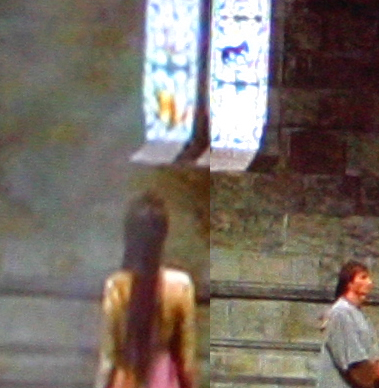

I actually did a comparison of DVD vs. BD using A Knight's Tale, and while I didn't quite have everything set perfectly, the difference between the two is astounding. The image is below, and both were connected via component, not HDMI - so no upconversion, but I will be redoing the test using the PS3 and my A2 for the DVD test, and the PS3 for HD playback.
The difference here, on my Pioneer 768p display (6070HD) is extraordinary...

EDIT: Here is the full size original images of Blu-ray Disc and the comparison DVD - no Photoshop or effects were used to alter these images at all.
http://www.avintegrated.com/images/bluraydisc/bluray_knights.jpg
http://www.avintegrated.com/images/bluraydisc/dvd_knights.jpg
