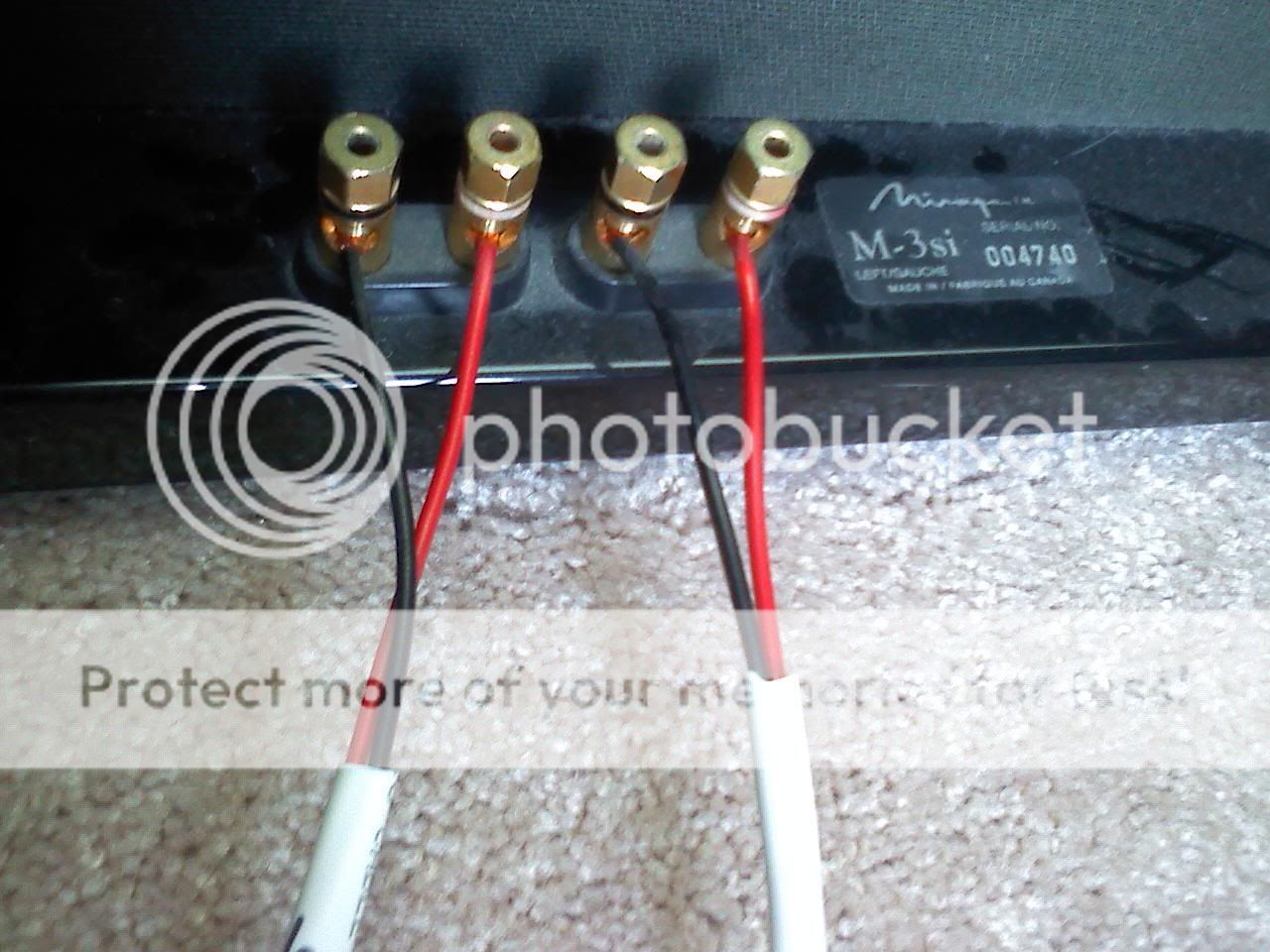

Sorry, the picture is a bit fuzzy, I used my phone. I use banana plugs at the other end, they are similarly clean. The cable is 14 gauge and for what it's worth the woofer connection is on the left.
The picture is a little blurry, but it looks like (from here) the red insulation is stuck under the lug.

Seth, you don't need to be a karma member to see the pix. Rick, I know it looks that way but it isn't. Also I do the switching with the banana plugs at the amps.
