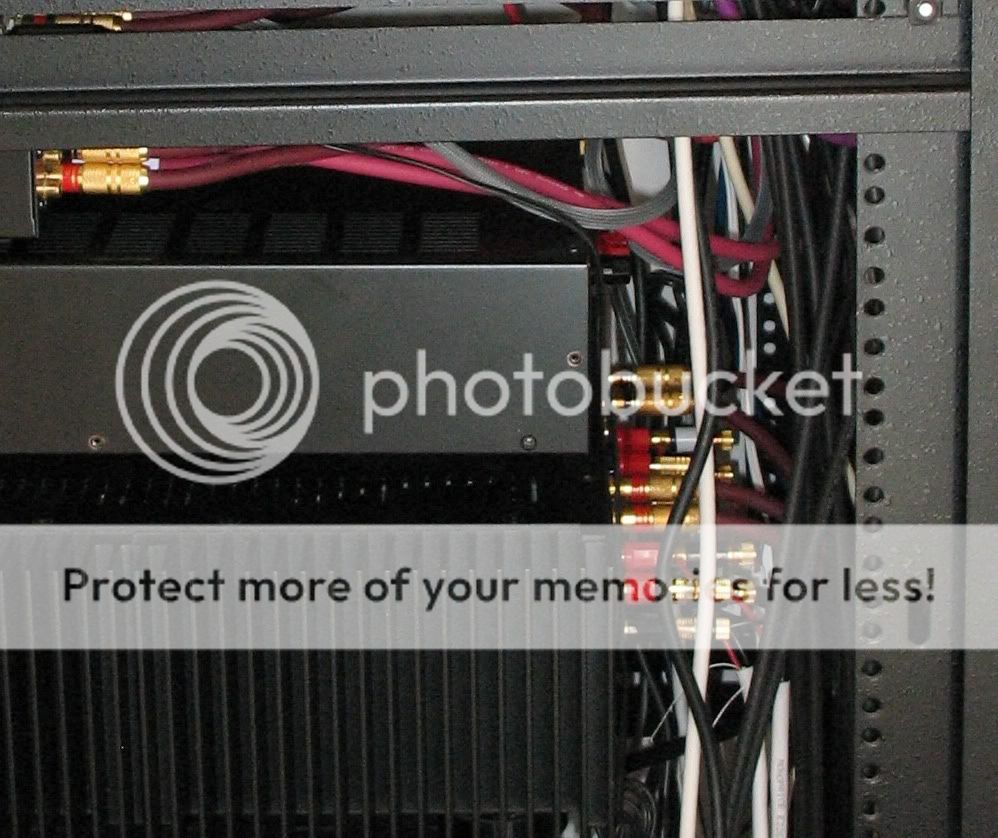

Can you post a photo of the speaker's terminals with the cables attached?
Sorry, the picture is a bit fuzzy, I used my phone. I use banana plugs at the other end, they are similarly clean. The cable is 14 gauge and for what it's worth the woofer connection is on the left.
edit: I added this picture I found, hard to make a lot out, but this is the amp side.
