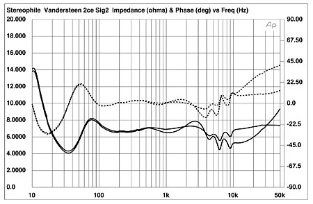

Impedance curve below, as measured by John Atkinson of Stereophile
The Onkyo is rated at 55W/ch and the Model 2 calls for 40W to 160W (assuming it's similar to the 2ce). Are you looking to buy the Onkyo or test one that you have? Would be fine to test out, but as mentioned, whether 55W is enough depends on how loud you listen and at what distance. Sensitivity is 88dB and impedance is mostly around 7 ohms so shouldn't be too hard to drive.
