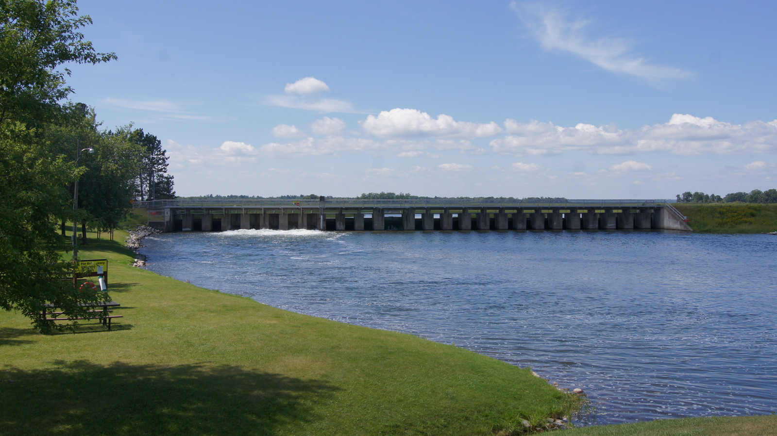

So we can boat to destinations like Earl's Bar at Federal Dam on the Leech River.
The Federal Dam on the Leech River. The first Dam was built there in 1863.
