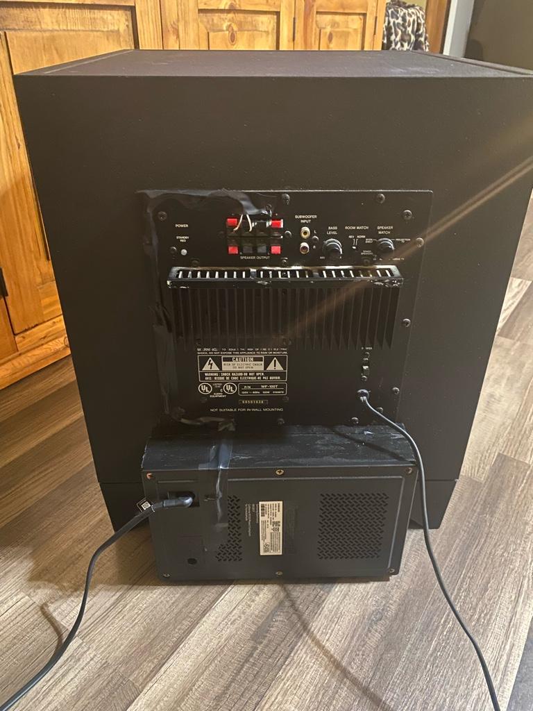

Well I guess I should update the thread to say I took the advice of removing the speaker wire from the speaker in the wireless sub and made it long enough so that I could connect it to the speaker inputs of my old sub and it sounds great. Nice, rich bass that blows that little wireless speaker out of the water.
But whether I needed to or not, since there is a left and a right speaker wire input on my old sub and since I didn’t see any markings over the terminals that said “bridged” for a mono connection, I just basically took the incoming speaker wire and spliced another set of wires onto each end so that I could essentially connect the positive into both positive terminals and the negative into both negative terminals. I guess I coulda just chose either the left or the right input but since I didn’t know, this seems to work.
Also, being that I just so happened to have one lying around, I almost took a piece of speaker wire I have that has a RCA plug on one end of it and just spliced it into the speaker wire to plug into the “mono” side of the RCA input but I wasn’t sure if the signals were the same, so I didn’t try it.
Anywho, it’s sounds awesome. Now I just gotta figure out how I’m going to stuff the electrical stuff from the wireless sub into the big box of the old sub so I can get rid of that other speaker enclosure.
Connecting the speaker wire to an RCA jack would have been a big no-no. The RCA inputs are a line level (very low level) signal compared to using the speaker terminals. You can also remove the wire bridging the left and right speaker terminal inputs on the sub. The sub is mono so you gain nothing and by bridging it with a wire with zero resistance you're actually changing the impedance on the input. Just use the one connection that's working.

corneileous
Yeah, come to think of it, I figured it was pretty much due to the RCA inputs being the low level input and the speaker wires being the high level input.
But you’re saying I can use just the right or the left speaker wire input terminal? I’m pretty sure both of them work, I just wasn’t sure what the best way to hook that up being that there’s just one speaker wire now because I guess when this sub is hooked up correctly the way it was meant, the wires that go to the main left and right speakers coming from the receiver hook to the appropriate L+R. inputs on the sub and then another set of wires goes from the output on the sub to the left and right speakers. I figured if one side was only connected then there wouldn’t be both the left and the right inputs.
Eppie
Eppie
Since you are tapping off of the one sub, it is already a mono signal. You only need to use both L+R inputs if you have a stereo signal, which the RCA sub then mixes into mono. You would use both L+R if taking the signal from a receiver so that you get both L and R channels, but the small sub already has the L+R channels mixed together, so no need to bridge the inputs.

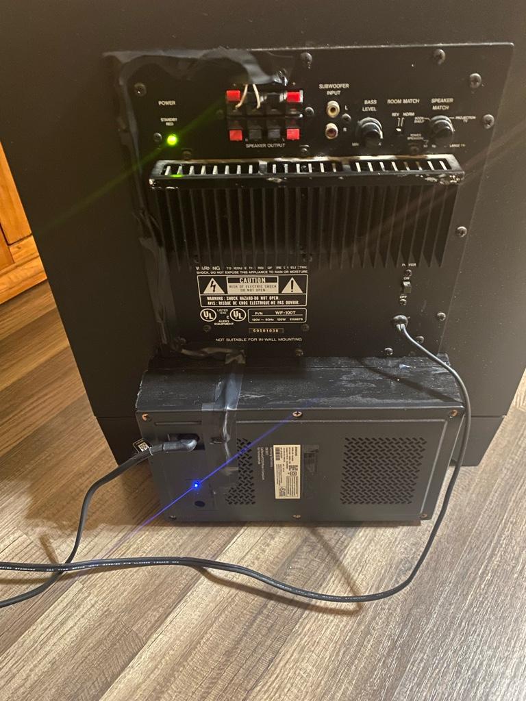

corneileous
Well, here it is, custom mod complete. I just used a stick of 1x2 pine to make the pieces for my wooden box and then just screwed the whole panel to to the top of it. No more little sub box sitting on top of the big one anymore….
