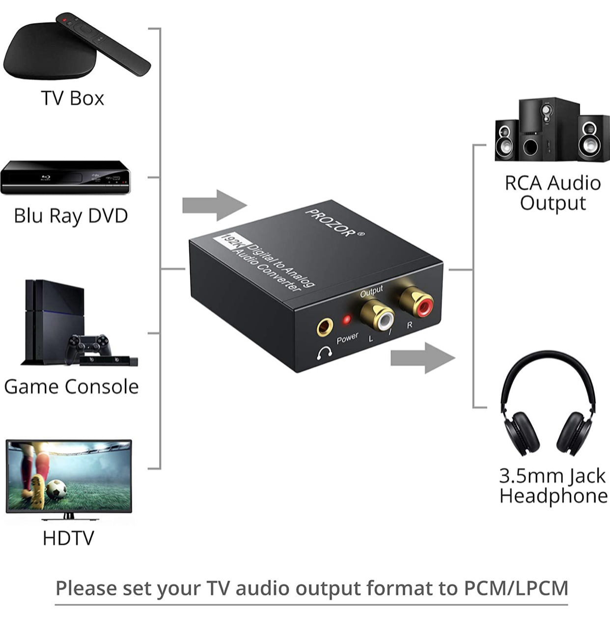

You mean this, or something like this?
PROZOR 192KHz Digital to Analog Audio Converter DAC Digital SPDIF Optical to Analog L/R RCA Converter Toslink Optical to 3.5mm Jack Adapter for PS3 HD DVD PS4 Amp Apple TV Home Cinema https://www.amazon.com/dp/B00KNNSKV0/ref=cm_sw_r_cp_api_glt_fabc_P0WR7QWMWFVDXMAGNYNX?_encoding=UTF8&psc=1
But yeah, I really miss the big ole Pioneer stereo tower system I used to have back in the day that had the dual tape deck, 50+1 CD changer, tuner and amp that had the ginormous 4way main speakers with 12” subs, a center channel speaker and two rear surround speakers. For 1500 bucks, that thing was the bomb. **Sigh**.
In that soundbar’s defense though, it’s not the cheaper one Walmart carried, it was about $350 at Best Buy when I bought it almost three years ago and sounds really good but I get it, you’re really limited with just a soundbar. Maybe someday I’ll be able to get a modern receiver and be able to have back similar to what I had back in the day.

Well, if they make an adapter that basically goes from an optical toslink to RCA I may just go that route and plug the sub directly into the TV but if I did that, I’d have to go back to using the TV ARC connection between my TV and my soundbar because I currently have the sound bar hooked up to the TV via optical cable.
It may not matter so much with a sound bar, but with surround setups HDMI is generally preferred to optical as multi-channel audio gets compressed and decompressed using optical (with say 7 channel DTS but not with stereo).
Trebdp83
Haven’t you cracked that subwoofer open, yet?;)The optical to analog convert is one solution but be careful about the output signal. I’m not sure if all do it, but some require conversion of audio to PCM before sending to converter. This is no good if one wants discreet multi channel and not a two channel upmix and not sure if you can bitstream from HDMI ARC while also converting optical to PCM. I’m guessing no and it would be PCM all around. Anyway, unplug and open up the back of the subwoofer and…:D

That would be a nice solution if the TV outputs to HDMI/ARC and optical at the same time. No need to open anything up. Might be some timing issues if the converter introduces some delay compared to HDMI, put probably not that critical for LFE. Good catch.
I haven’t been home yet to even mess with that subwoofer but when you say to crack open the wireless sub and disconnect the wires from the driver, what exactly is the driver? Are you talking about the internal amp in the older powered sub and basically powering the old sub through the wireless one basically by bypassing the internal sub and amp of the wireless one?
But yeah, I noticed that about that optical to RCA converter where it said to change the audio output on the TV to PCM which, as far as audio quality goes, I don’t know why that would be exactly a problem because there for the longest time I was using PCM on the input in the output settings while still using the HDMI ARC connection from my TV to the sound bar but, switching the input over to bitstream and then changing the output to bitstream using that DTS Neo 2.5 or whatever it’s called, I do get a lot more volume in my sound.
