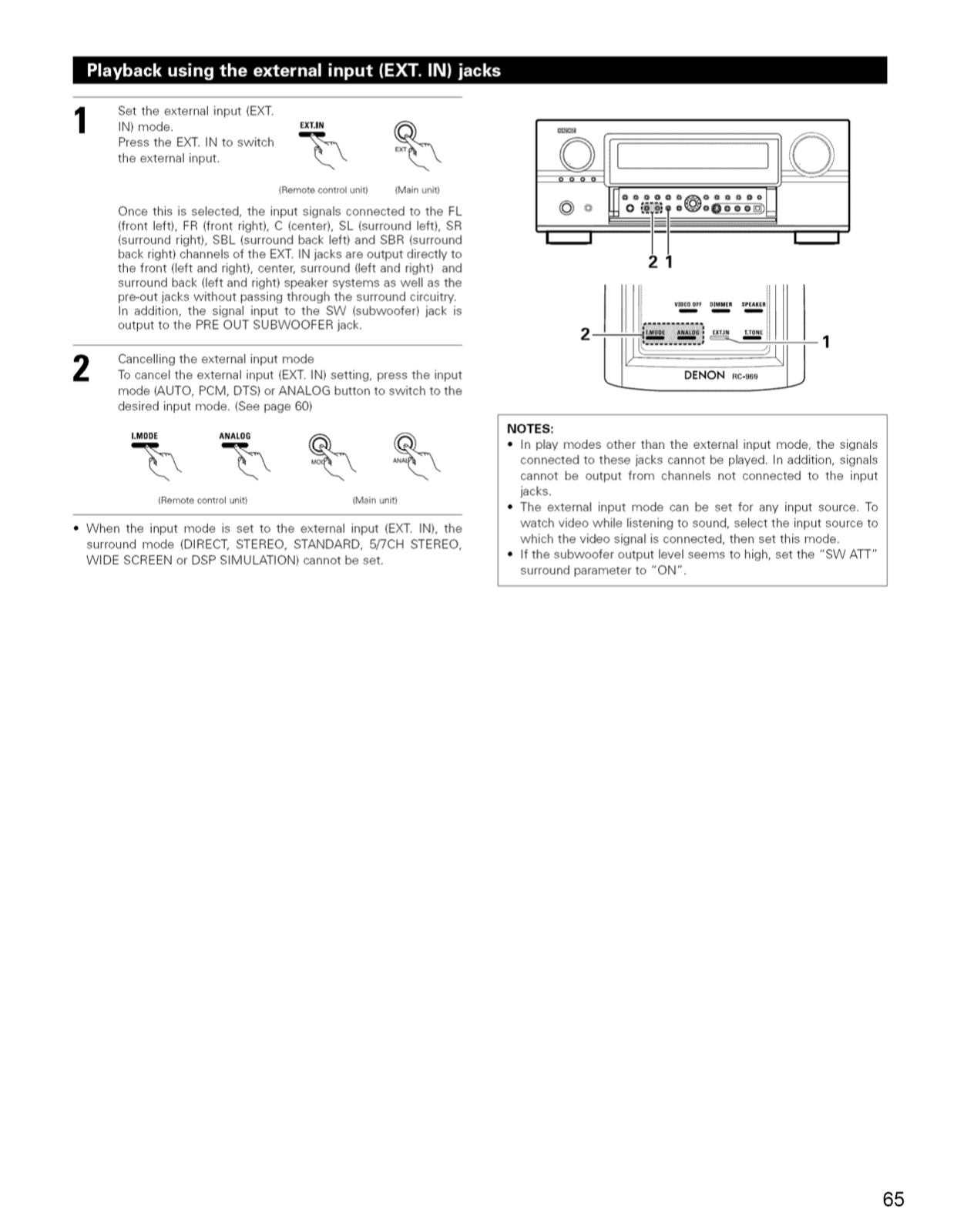

Trebdp83
If using the 3805 as an amp, you set the 3805 to the EXT. IN input. It will disable all processing and simply power speakers connected to the corresponding channels. The X3700 will handle all processing of the audio.

If using the 3805 as an amp, you set the 3805 to the EXT. IN input. It will disable all processing and simply power speakers connected to the corresponding channels. The X3700 will handle all processing of the audio. View attachment 43608
What volume setting should I set the old denon receiver?
Will any of this affect the Audysey setup on the 2700
You'll need to rerun Audyssey if you use your old avr as amp with the 3700 (just like you would with any other external amp on the 3700, to account for gain differences). I'd probably set volume close to reference on the old unit (0/82 depending on volume scale in use and I'd run a full reset on it as well), maybe a bit below that, believe the preouts on the 3700 have been tested fairly clean at such level.
