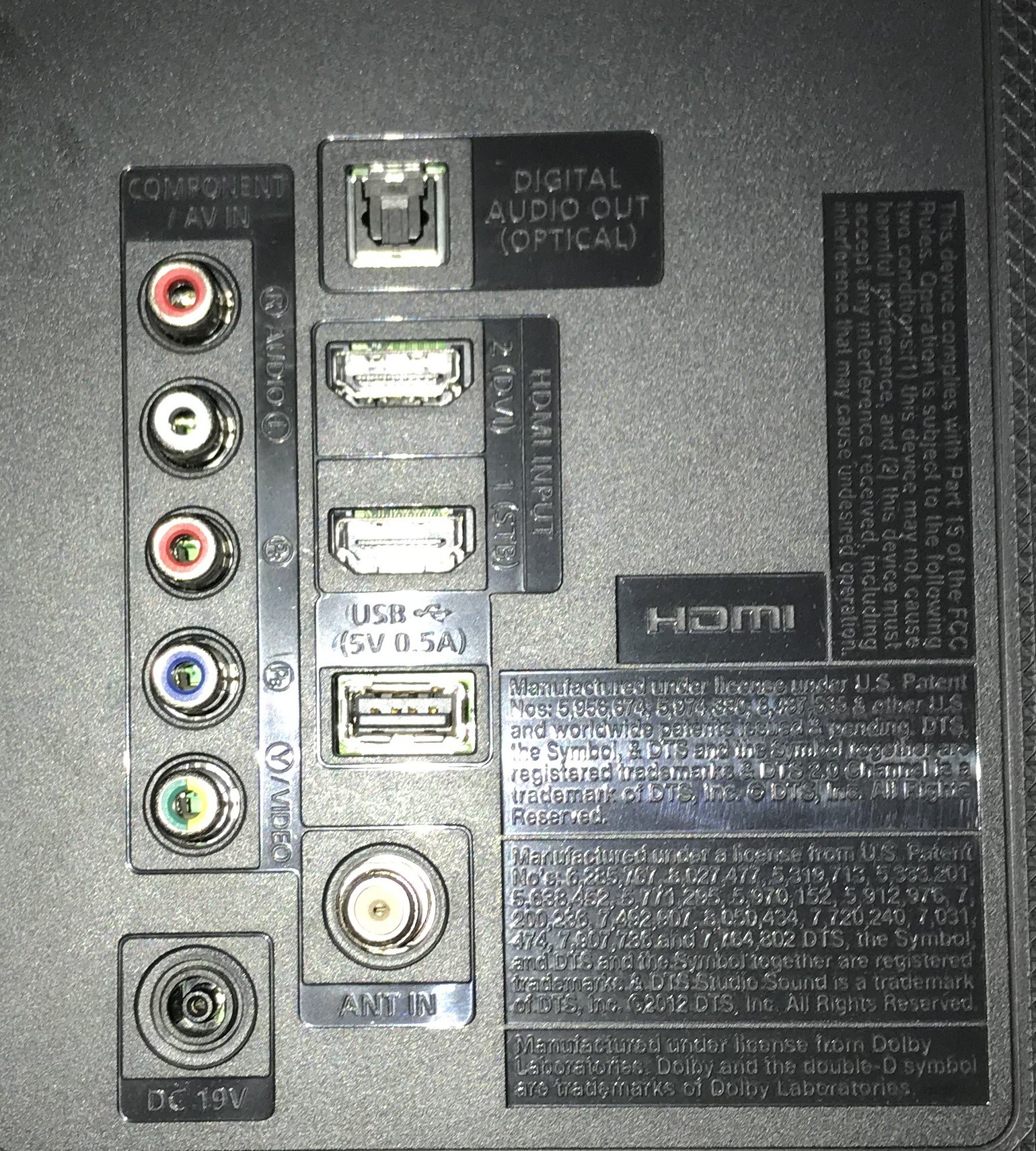

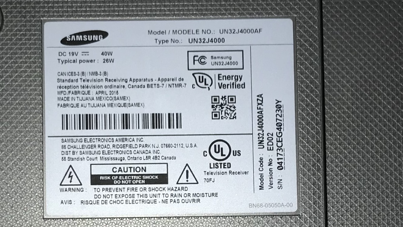

TV Info -
Samsung 32inch
Model No - UN32J4000AF
Tv Inputs - Right and Left Audio, Pr, Pb, Y/Video, 1 HDMI DVI, 1 HDMI STB
TV Outputs - Digital Audiot Out (Optical)

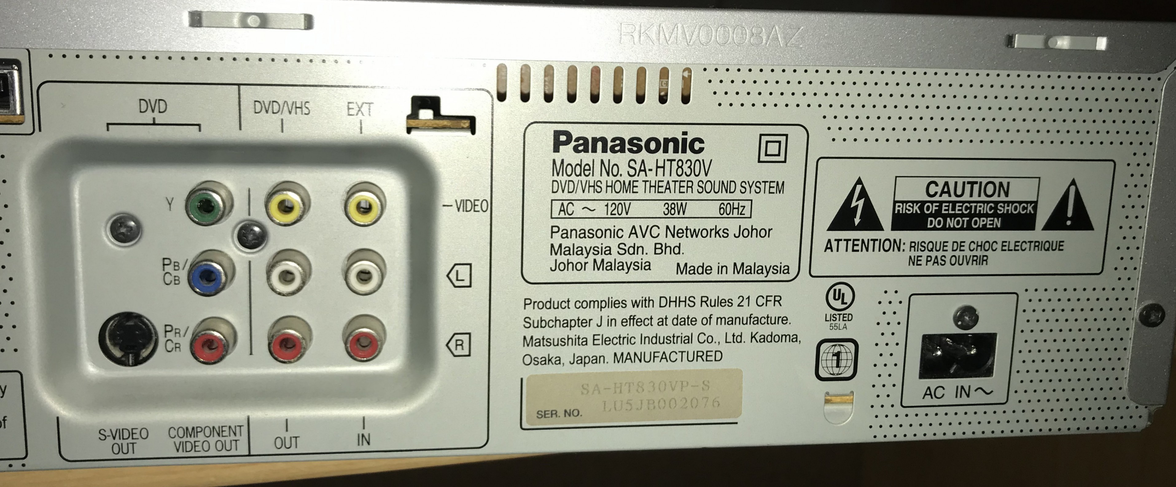

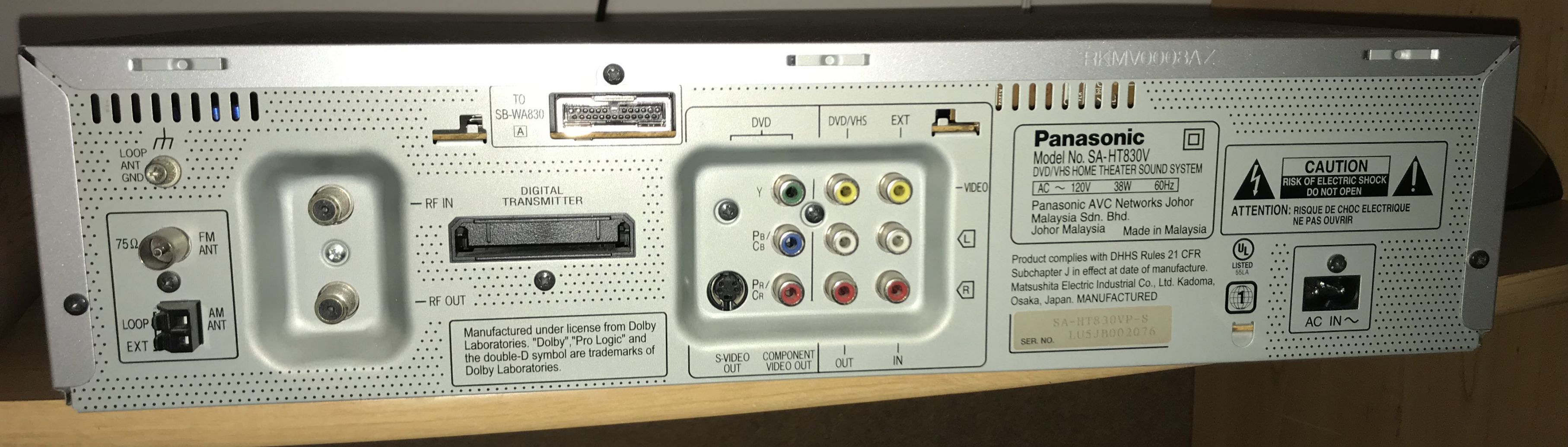

Home Theater Info -
Panasonic DVD/VHS Home Theater System
Model No - SA-HT830V

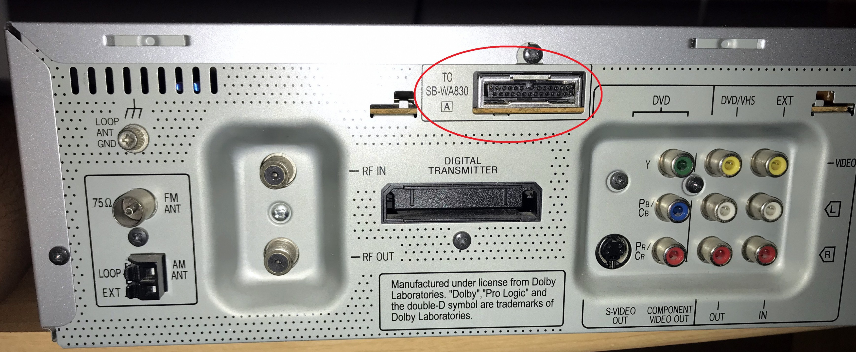

I have drawn a Red Circle on the pic to show the output to the speaker from the Home Theater Base.
I have attached pics for TV and Home Theater System.

They make optical to RCA converters. You can find them pretty cheap on Amazon. I've never used any of them, so can't comment further on them.
Hey thanks there,
So my goal is to actually use this as external speakers to my TV. I don't want to play any DVD or VHS through this. I just want some converter or etc to help me play TV sound out of these speakers!
Not sure but if you can suggest that would be great
You can get two channel audio out of the TV that will play from the right and left speakers. That is all a DAC from the Toslink out from the TV will give you.
You would connect it to the white and red external inputs.
Far I think from what you wanted in your original post. So you are not going to get multi channel sound from your unit. There is no way to do that.
If proper surround sound is what you want then you need to give up HTIBs and get a modern receiver and compatible speakers.
Your other option is a sound bar, but you don't get amazing sound from them.

Okay I'll try doing that, if you don't mind, can you assist me with the right converter from digital to analog? And where would I plug in the output in the Panasonic, can you check the image and tell me? Thanks!
Read my posts 12. It gives you a hype link to a suitable DAC and tells you how to connect it! You already have your answers.
