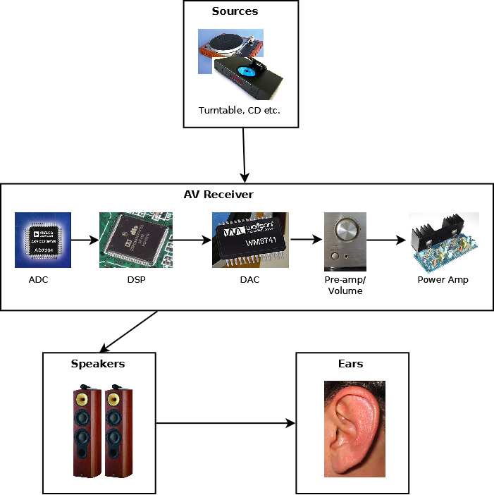

I think everyone should read some free ONLINE archive articles from THE AUDIO CRITIC before spending one dime on audio. :D
If you want the cheap, fast and dirty recap:
1. Amps, Preamps, CD players, Cables/Wires do NOT have a sound signature of their own.
2. Processors (DSP, EQ, Tones) will all sound differently.
3. When LEVEL-MATCHED and working within their limits, all amps, preamps, AVR and AVP will sound about the same in DIRECT MODES (No DSP, EQ, Tones).
4. Most of the time, your speakers don’t really need much power since most of us listen to an average sound level of less than 85dB. Thus, most AVR have enough power without using external amps.
5. The ACD rule. ACD = ALL CHANNELS DRIVEN (like 200W x 7 CH driven). ACD is a torture test for amps and AVR. In REAL LIFE we won’t encounter ACD. So focus on the 2CH Power Test (100W x 2CH into 8 ohms, 150W x 2CH into 4 ohms).
Now with that said, if you want an integrated amp, that’s perfectly fine also. There’s no wrong way.
