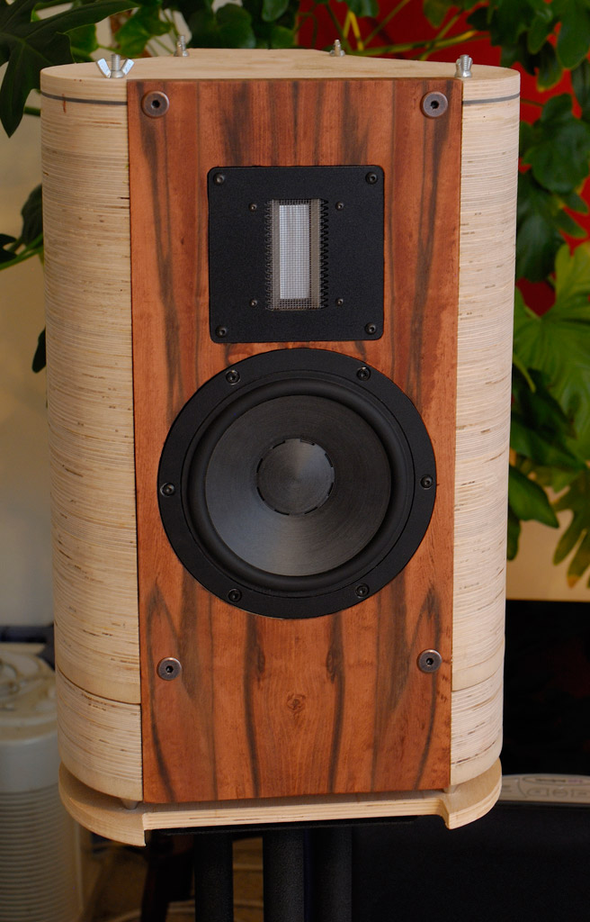

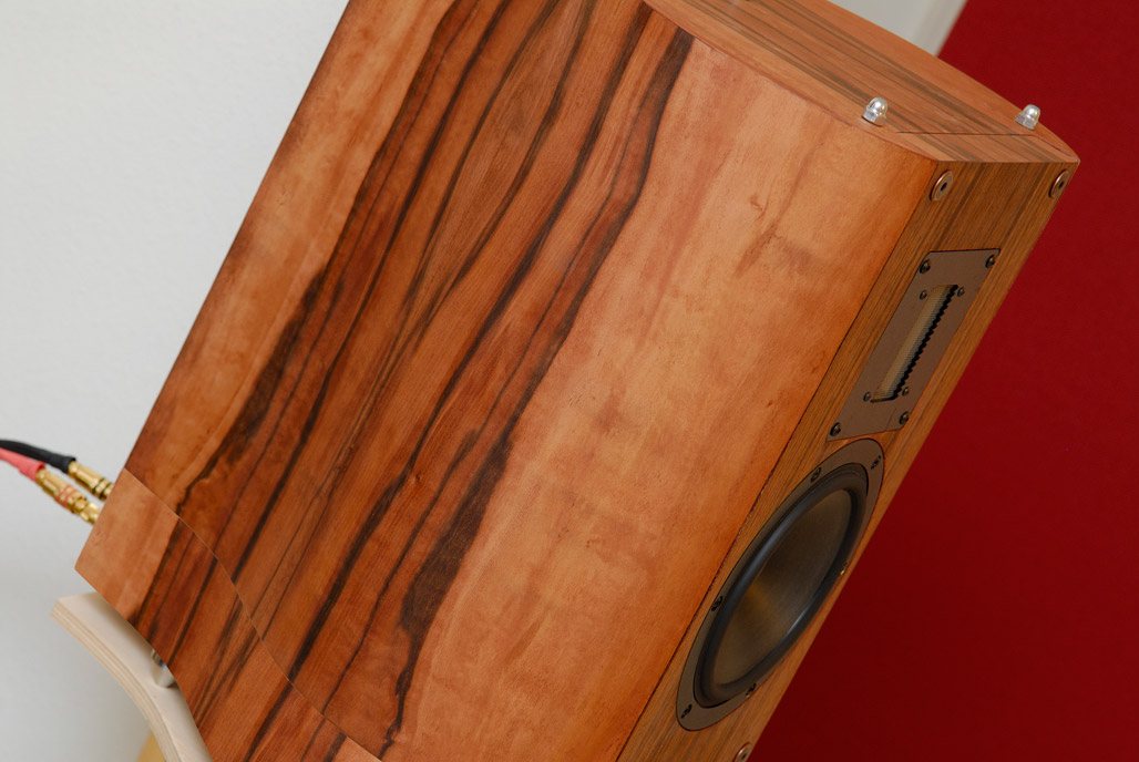

More progress, the hi-end design is pretty much finalized ... just a bit of finishing work on the cabinets and getting the cabinet tuning right where I want it. We had a great get-together last night at a local friends house, 6 people attended and all thought these were something special. They're just completely transparent, they're fast, accurate, and image like crazy. Bass right now is I think very well balanced, some thought it was a bit light ... so that's all that's left to work on.
Here's pics from today when I brought them back home setup in my 2nd listening room. The veneer that's on the left baffle and the right cabinet is Tineo, that's what they'll be done in completely. The baffle on the right is Tropical Olive, I'll re-cover it with the Tineo. You can see the separate crossover section at the bottom too.

Extraordinary looking speakers, Ryan... thank you! :)
The Tineo veneer, judging from your pictures, would be my choice, as well.

Thanks for the kind words Kevin ...
Veneering is one of my favorite parts of speaker building. I have probably 40 different species that I've accumulated over the years, all exotic and unique. Nothing beats the first wipe with Tung Oil on a new sheet of freshly laid veneer :)

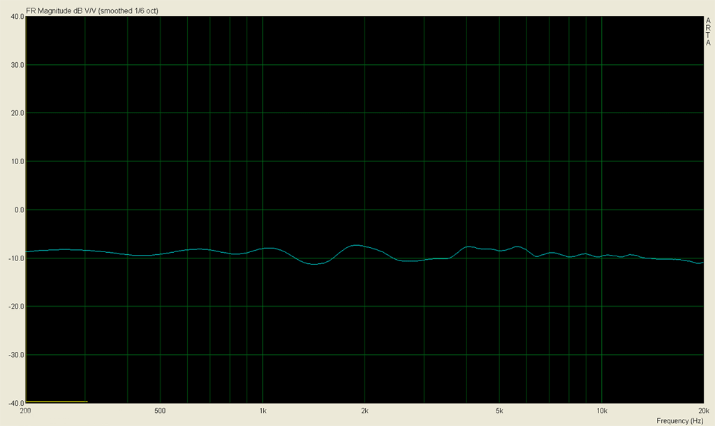

How's this look for a FR curve? Measurement taken at 1m, 1/6 octave smoothing, on tweeter axis, 9.5ms gate time.

How's this look for a FR curve? Measurement taken at 1m, 1/6 octave smoothing, on tweeter axis, 9.5ms gate time./QUOTE]
not too bad, looks like the RAAL is a great deal. Are the off-axis in the same line? I've tried to get in contact with Alex for a pair of these some time ago, but never received a reply from him. Lucky you!
Enclosure: I would appreciate to see a near-field measurement on the woofer. The LMS measurement doesn't show what the mid/woofer does, due to the setting of the timeframe.
Put the mic at about 1 or 2 inches from the bass driver and measure without smoothing or timeframe (no cut-off on the responce curve).
If your measurement is right, then you should see the standing waves in the enclosure (they are much lower than with classis style encloseres, although unfortunately still there).
