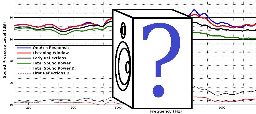

Over the last couple of years, Audioholics’ speaker reviews have contained graphs that have prompted questions from many readers about the meaning and importance of the information displayed in them. Some readers have found the information in them confusing, and that is our fault for not recognizing how cryptic these sort of representations are for an average reader. It can be easy to take these sorts of data visualizations for granted when one spends so much time dealing with the minutiae of loudspeaker behavior, and that can sometimes lead us to assume too much knowledge on behalf of the reader, especially novices to the audio hobby. In this article, we explain frequency response and the set of frequency response curves known as the 'Spin-O-Rama' curves.
