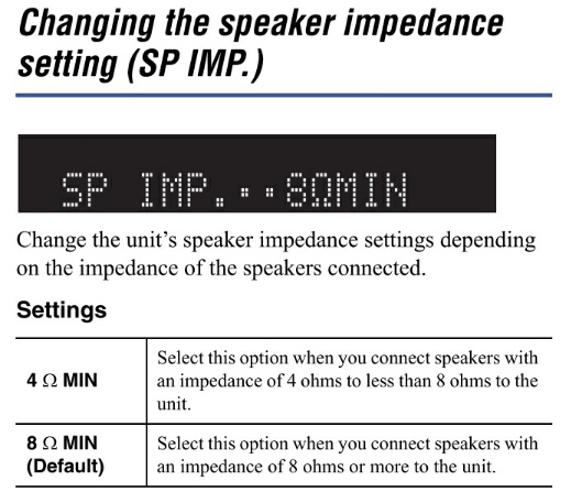

Thanks a lot, very kind of you to give me all this time of yours.
regarding this last point, shouldn't the impedance of the Yamaha be set to 4 ohm if that of the speakers is 6 ohm?
Attached instructions from the manual.

Thans a lot.View attachment 48335View attachment 48335
regarding this last point, shouldn't the impedance of the Yamaha be set to 4ohm if that of the speakers is 6ohm?
There is at least one Audioholics.com article related to this topic.
Example:
Setting the A/V Receiver Impedance Selector Switch | Audioholics
The article was published in 2015, in which when Gene stated:
"This article explores why the impedance switch exists and its intended purpose. Because of liability and the litigious society we live in, I can't tell you to ALWAYS set the impedance switch to the high setting for 4 ohm loads, but I can show you the facts on what this switch does along with supportive data for you to make your own educated decision."
In one of his recent videos, he seemed to have talked about this more openly, may be he now has good liability coverage lol..
Jokes aside, basically, it you set it to 4 Ohms, the device would switch the rail to a much reduced voltage. It is not a unique scheme used by Yamaha, others including Denon, Marantz all use the same trick if they offer such a selector. Reality is, if you leave it at the 8 Ohm setting, the R-N803 would actually be able to output much more "watts" into 4 Ohms as long as the impedance does not stay at 4 Ohms continuously.

Ok, so i should leave it on 8 ohm, even if speakers have a 6 ohm impedance? Ok, i'll follow your advice, you know a lot more than i do.
Anyway, when i tested the Yamaha with 4 ohm set, it seemed to me more powerful and louder, that was my impression

Yeah... to me this is just more evidence of expectation bias. The 4 ohm selector switch limits power. The complete opposite of what you reported.
