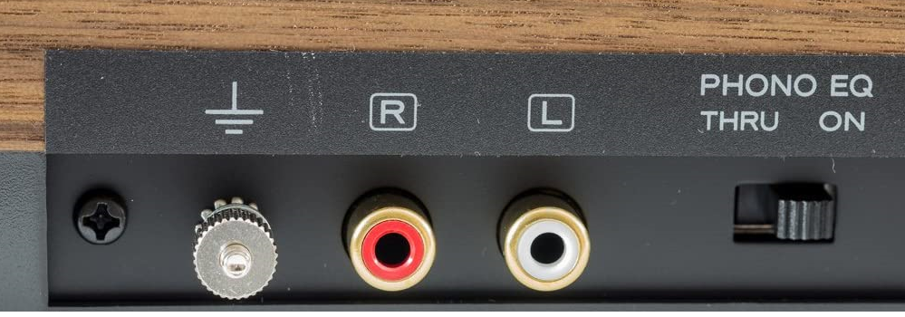

Does the back panel of your turntable look like the photo below? It apparently has an internal phono pre-amp and a switch (labeled PHONO EQ) to allow you to use it (ON) or bypass it (THRU).
TLS Guy suggests you might also have induced hum from your integrated amp. If so, slide the PHONO EQ switch on the Teac to ON. You must also move the cable connection on the back of your integrated amp from the phono input RCA jack to any other unused RCA input. That will raise the signal in the cable between the turntable and the amp to a higher voltage that may make it less susceptible to hum.
If you use the McIntosh's built-in phono pre-amp, be sure the turntable is switched to THRU.

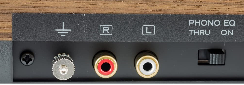

Thanks, guys! I tried Swerd's preamp suggestion and it resolved the hum issue that a couple of you opined on - probably would have tried it eventually myself, but, using the internal phono preamp on the TT did the trick!!
That hum is all gone, except when I turn the volume up all the way and stop the platter. Then there is such a low hum that you have to put your ear up close to a speaker to even hear it. Turning the platter on raises it so little that it is still hardly discernable. Previously, the platter hum was unbearable - I thought it was a motor noise issue!
Another change was in turning the loudness contour off. I think I know what LP I turned it on for and forgot to turn it off :rolleyes:. Walls don't rattle now and the cabinet vibrates a lot less at higher volumes. I have almost always had the preamp in the "flat" position.
I'll deal with the acoustic feedback next - not so urgent now. The patch cords are only 3', and it's 2' between the cabinet cord holes, leaving only a foot from the holes to preamp and TT panels - much too tight in an enclosure. So, need to order cables (probably 4') before trying TT inside the cabinet again.
