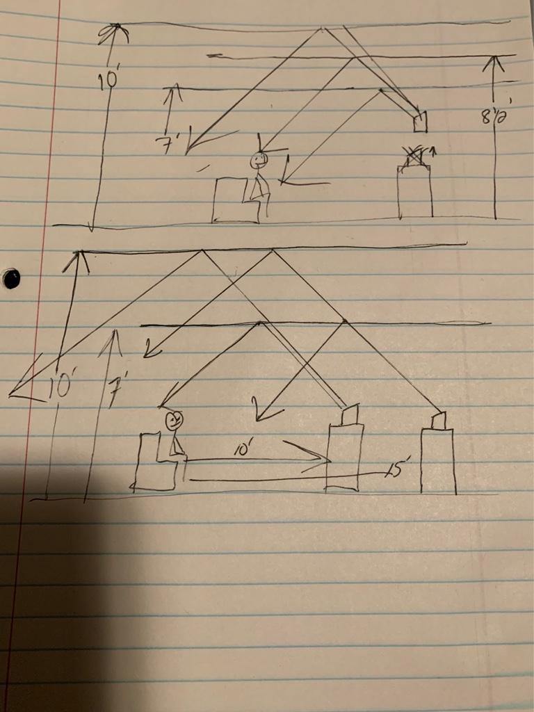

I agree with Ryan. A different subwoofer should be on the list. And if you’re going to go with “Atmos Enabled”, I would go with modules that can be positioned separately from the mains. AE speakers can take a lot of fussing with to get the effect right.
Here’s a doodle I made for a completely different thread, but the idea is to show how the “bounce” might be affected by different ceiling/speaker heights.
You’ll need some imagination to see how changing the angle of an AE speaker would work, but just try to imagine a bank shot when shooting pool. It’s kinda like that.
Again, this is not really to a “spec” but just to kinda see how changing some variables might help or hurt the installation.
