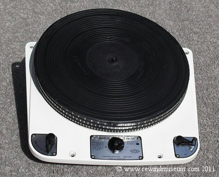

Getting back to the hey day of idler wheel turntables the first transcription grade turntable has to be credited to AR Sugden.
And then of course the legendary Garrard 301.

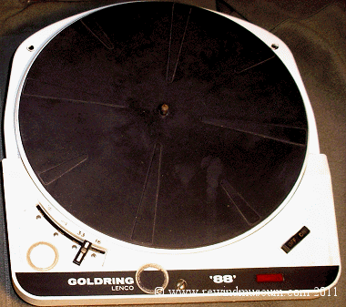

Of the Goldring Lenco, (although Goldring moved to the UK in 1933, these Lenco turntables were Swiss made) my favorite is the GL88.
I doubt the visual similarity is a coincidence!

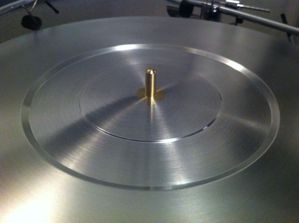

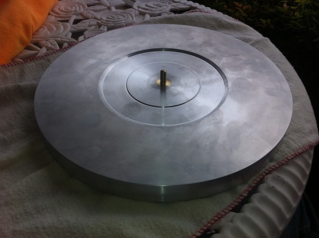

I just picked up my record clamp & platter extension I had machined out of aluminum. Actually I didn't realize the machinist was making them. I asked for a quote & got the parts made haha!! I need to have the spindle extension made now. I'll post pics when finished, should make a nice improvement in both audio quality & looks of the table. It's almost finished!! :)

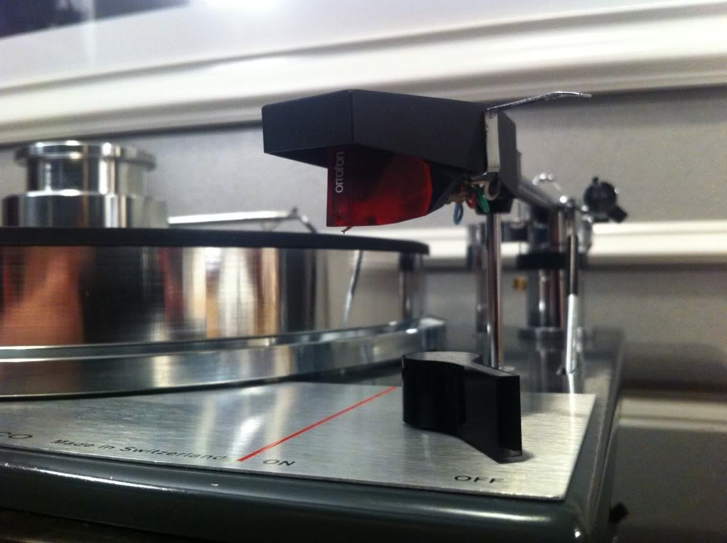

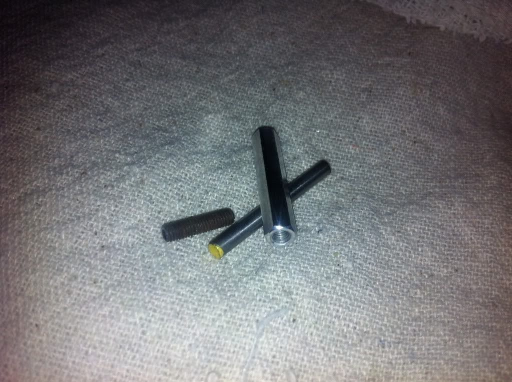

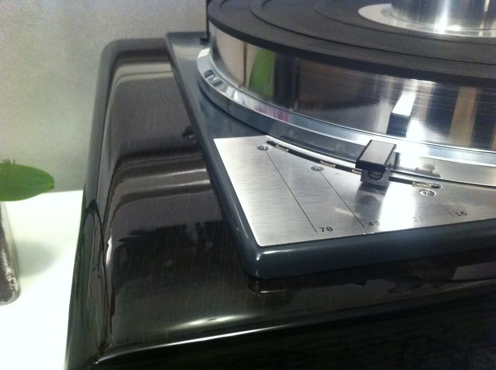

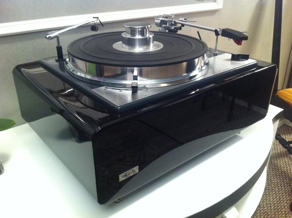

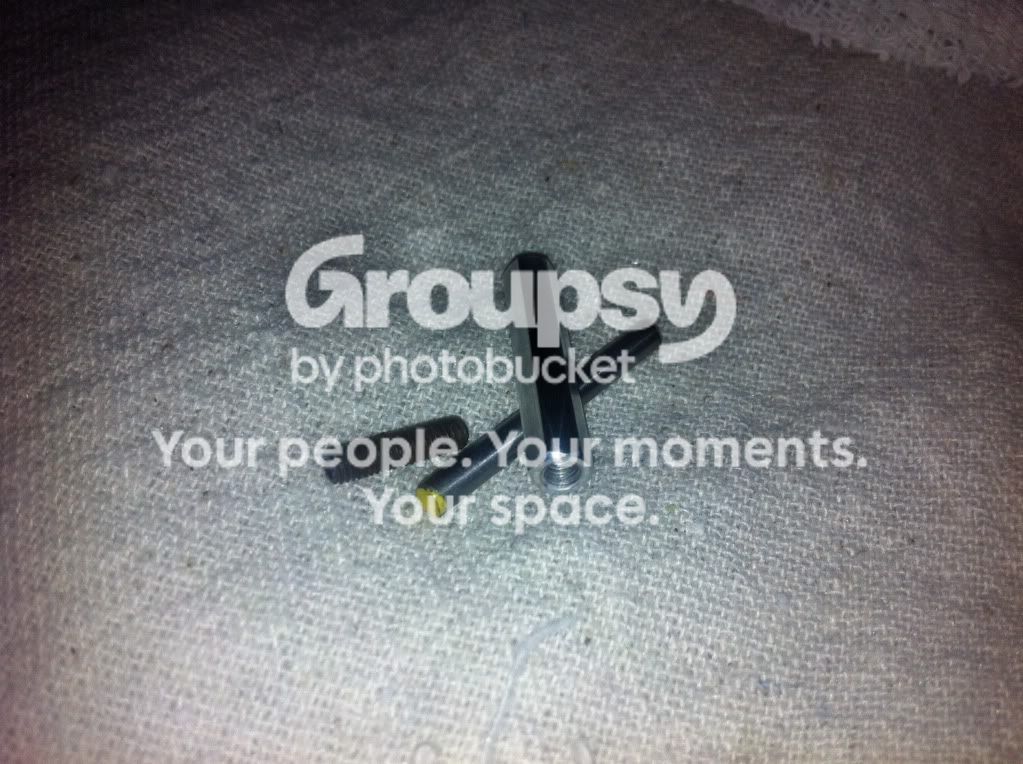

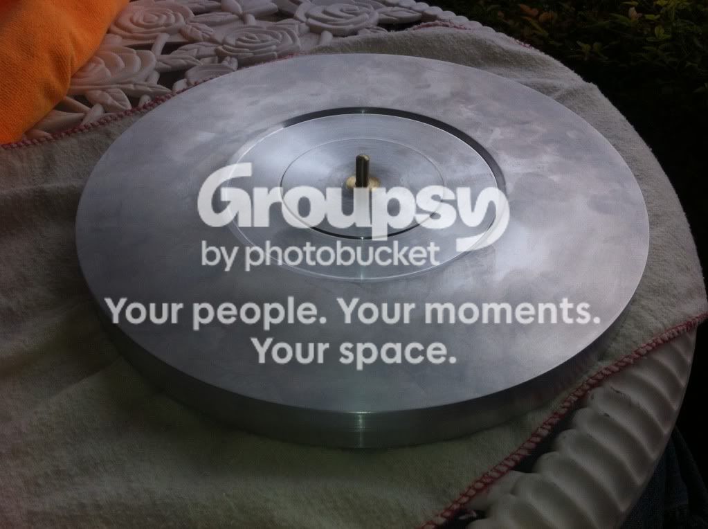

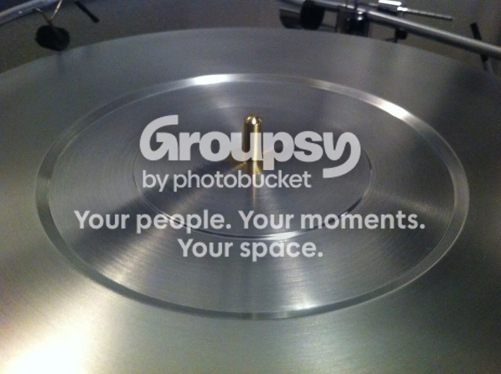

Well since we have gotten a little off topic & are talking a bit about analog audio & idler drive turntables, i thought id show a few updated photos of my Lenco L75.
A lot of Lenco owners will purchase a second platter to stack on top of the original, therefore doubling the rotating mass to increase inertia & reduce transfer of vibrations. Well unfortunately i was unable to locate a second platter...so i designed & had something similar machined out of solid aluminum. It is 1" thick & is approx 11.75" in diameter. In order for the "platter extension" to line up with the original platter I had a brass spindle extension made as well. The brass is press fit into the aluminum platter & has been turned together for a seemless blend. The new platter fits like a glove over the original spindle.

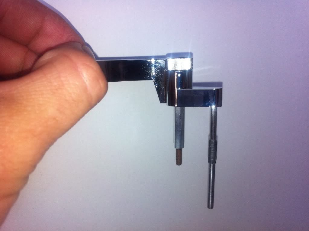

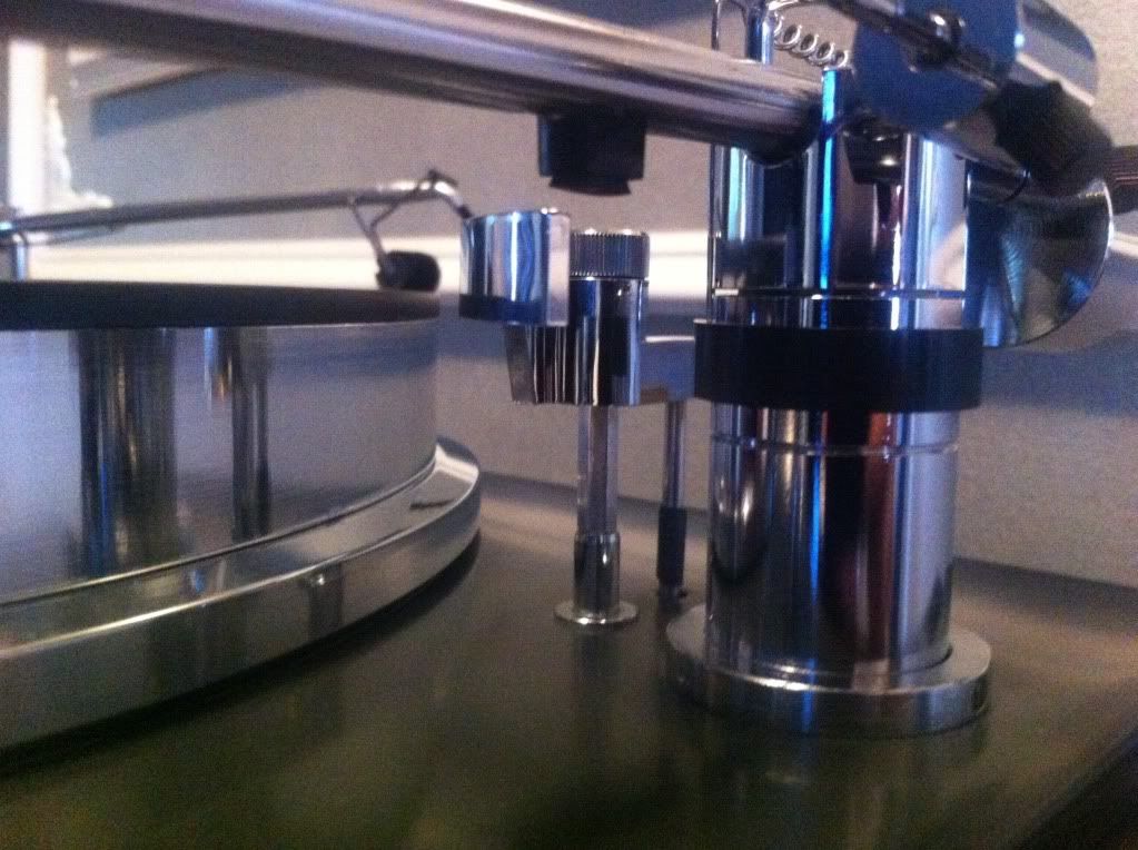

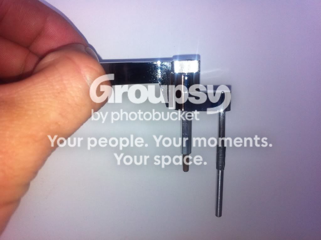

Once the new platter was finished & installed i then had to raise the tonearm...no problem, raise the cradle...no worries...raise the arm lift...big problem! The original arm lift will not reach the tonearm once it has been raised 1". So i had to order some parts from McMaster Carr (large hardware company) I got a 3M coupling nut, 3M threaded rod & 3M smooth rod. These were perfect in getting the arm lift to the proper height so that it could reach the new tonearm level.
timoteo
timoteo

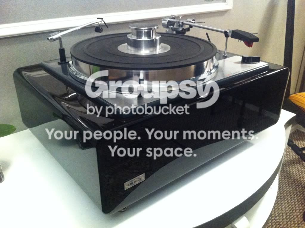

So after all that designing...machining...polishing...etc. I finally have a complete Lenco L75 rebuild that sounds great & is being used on a daily basis!! This has been one of the most fun projects that i have undertaken & the results have been nothing but pleasing. Here are a couple pictures of the final product. The aluminum record clamp was also made to spec at the machine shop that i use.
There are more photos of the turntable project in my photobucket acct that is linked in my signature if interested. I hope you enjoy the photos!!

Beautiful!:eek: How does she sound?

Afterlife: she sounds fantastic to me!! I don't have a lot of experience with TTs but as I made progress I could definately hear a very nice improvement. The biggest improvements coming from the new cartidge, trying different tubes in the phono stage & adding the platter & weight. It has really changed the way I enjoy music now!!!
Grador: Well good thing I don't work at a machine shop because I enjoyed custom designing some of my table & seeing it all come together. The shop I used is a very small, owner/operator shop named VDJ Machining in Cerritos CA. The office I dispatch from is in the same bussiness complex so Ive known the guy for a while. He does all my machining. Sometimes he hooks little stuff up free & I'll get him gift card or something. Hes a good guy!!

I kid, I kid (mostly). I really like the look of the press fit brass spindle insert, and think the overall design is very attractive, hats off to you.
