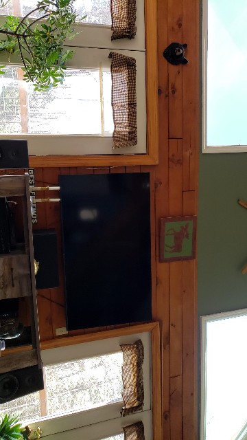

Not a standard house at all. 17' peaked ceiling, back of room is open to a kitchen and an open stairway. Also, 2 6' wide French doors on either side of stereo... wood stove in one front corner, and a hutch in the other. I think the room correction program is a must! For me, anyway. Ill keep my eyes open for denon. Thanks!

Not a standard house at all. 17' peaked ceiling, back of room is open to a kitchen and an open stairway. Also, 2 6' wide French doors on either side of stereo... wood stove in one front corner, and a hutch in the other. I think the room correction program is a must! For me, anyway. Ill keep my eyes open for denon. Thanks!View attachment 46659
You're almost describing my room with the kitchen and vaulted ceilings. Plus I have an open room on the right.

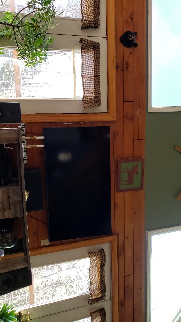

there is a view of the front and rear of the room, a view of the front fight and left corners, and also a view from my chair(as I am not centered on it, I am a bit askew)

What can I do?
I think that vaulted ceilings can actually be a plus compared to a lower flat ceiling. You do have some issues with placement imo. Your main speakers look kinda close together and the windows behind aren't doing you any favors either. You can't exactly spread them further apart without being in front of the doors so that's a no go. You have some challenges for sure. I'd want the speakers away from the wall and out into the room a little more. Not a lot, maybe pull them out 4-6 mote inches. Some toe in too. It'd help if you could have some more distance between them.
If you could possibly do some rearranging you might realize some improvements, but it depends on how far you're willing to go. I'm talking getting your tv and speakers off that side of the room altogether. I can imagine light coming in on either side of your tv would impact your viewing experience too, at least during the day. I think those doors on either side are problematic.

Yeah, I can't have them in front of the doors, my wife hates it. Toe in- should they be pointing directly at me, or just "slightly" at me? Yes, light comes in and blinds us. But we can't change the room around, this is the way that makes most sense.
I can pull the speakers away from the wall a bit more.
ddjr
they are out in front of the shelf a bit now and do sound better, however that works! But yeah, I'm sure my wife will see them and say they are too intrusive to the room...
