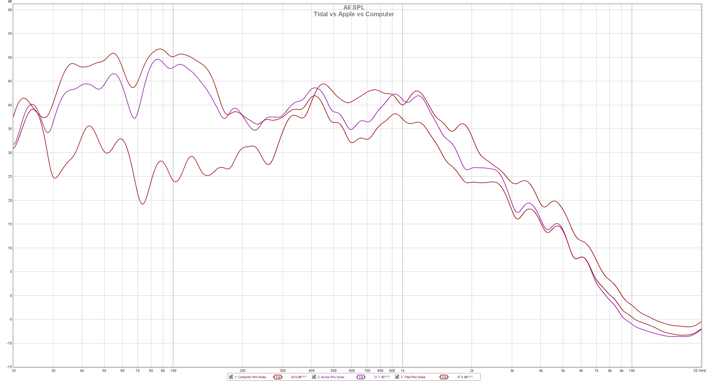

Hello Everyone,
I'm trying to figure out what differences I'm hearing in the two streaming services. Both are being Airplayed to my Denon receiver. I hear a noticeable bump in the bass and mid-bass from tidal compared to its apple music counterpart. Has anyone else experienced this? I'm not sure it warrants the extra cost but I much prefer the sound of Tidal, especially on my Klipsch Heresy and Klipsch Forte given how forward the midrange already is on these speakers. I get the grunt I've been searching for especially in some of the 90's grundge and rock I love so much. It feels more full in Music like Gregory Porter and even in something like Paul Simon and Dave Matthews Band. Thoughts?

Did you level match to compare, or ?
Level matched. Using REW. I did find out that the Music EQ in apple IOS functions during airplay. I was not aware of this. I thought only through bluetooth and using it directly connected. I had it on Vocal boost which is why I was getting such a huge boost in the midrage and was also tricking my brain into thinking there was more way more bass com,ing from tidal when the bass was pretty close. Still a tiny more for tidal but not the discrepancy I thought. Turned off the sub to run these tests and look at the difference in bass response between streaming from my phone vs from the computer.
Computer output consists of a Focusrite Scarlette 6i6 out digital coax. Everything on the receiver is set to zero. No tone control.
