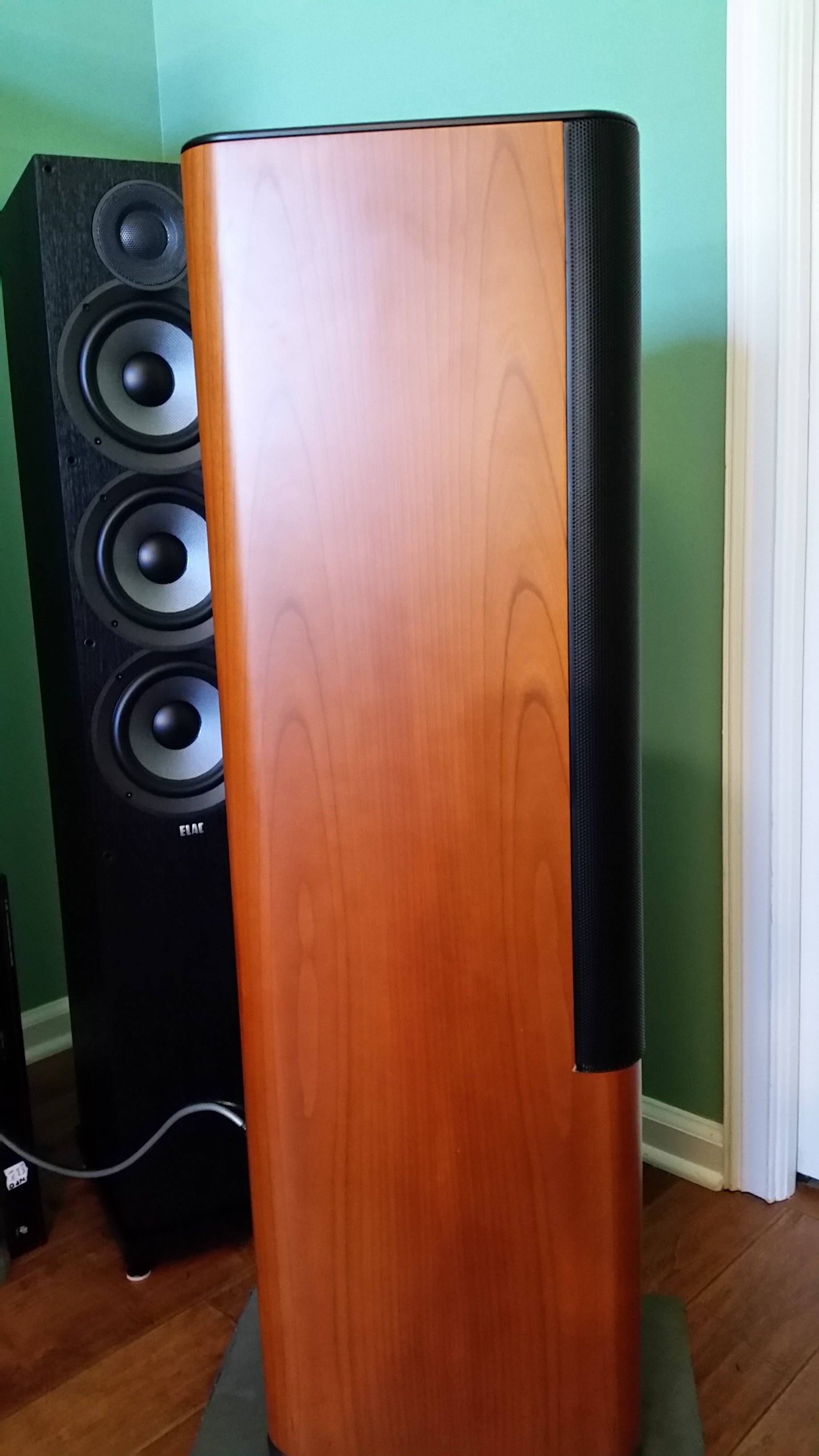

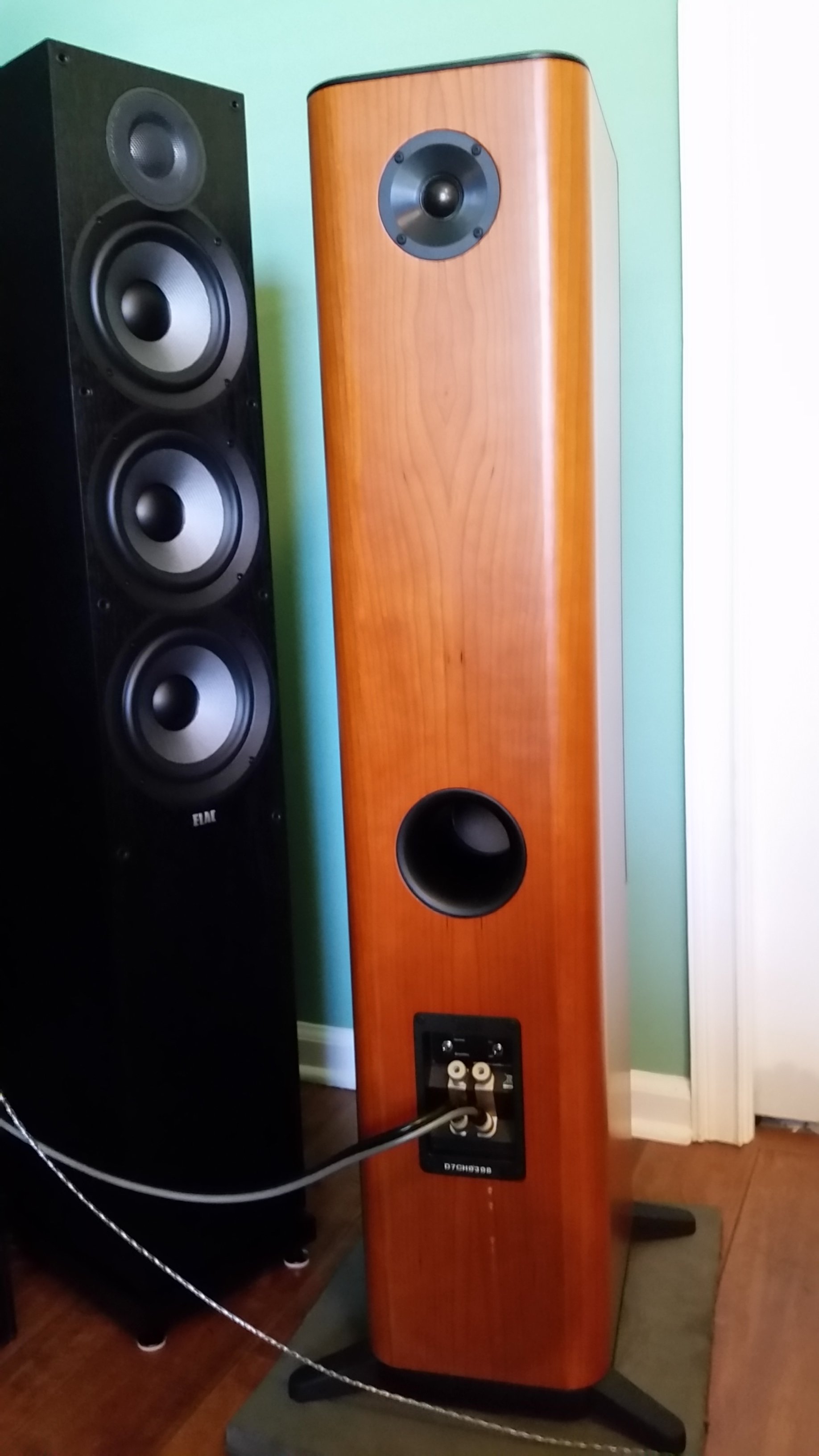

View attachment 30907View attachment 30908
In your second picture, is the tweeter on the back of the speaker?
Shanman
Shanman
Yes, there is a soft dome on the back of each tower. Down near the speaker connects are two switches, one for a "boundary" setting and the other to turn the rear firing tweeter on and off.
IMHO, That is part of the "Snell appeal"!
They are not just another speaker company! They took their own approach and did it well to make some very fine speakers!
The rear tweeters are designed to add depth to the sound stage. Unfortunately I have never heard these, but I like the Snell gear I have heard.
