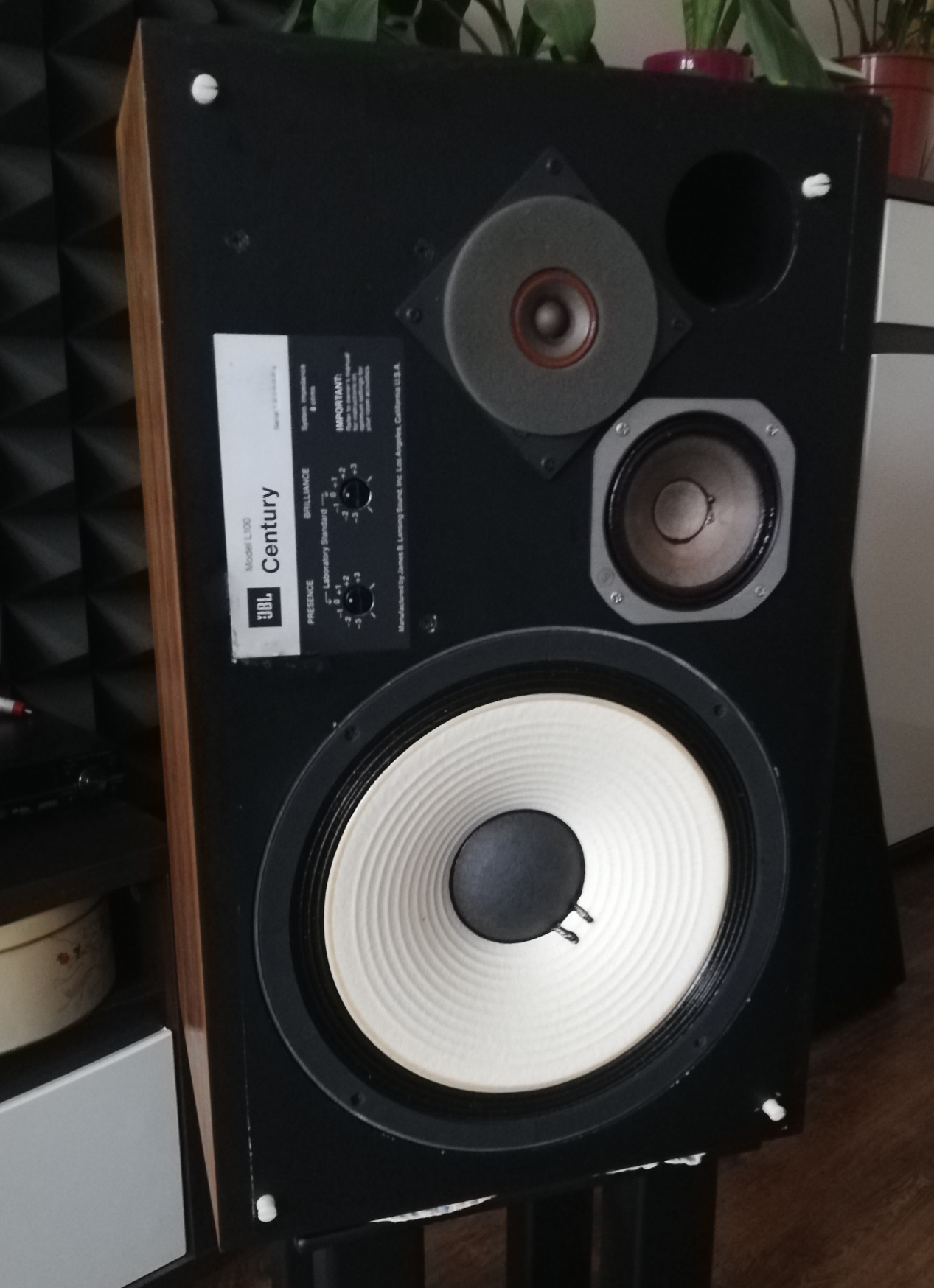

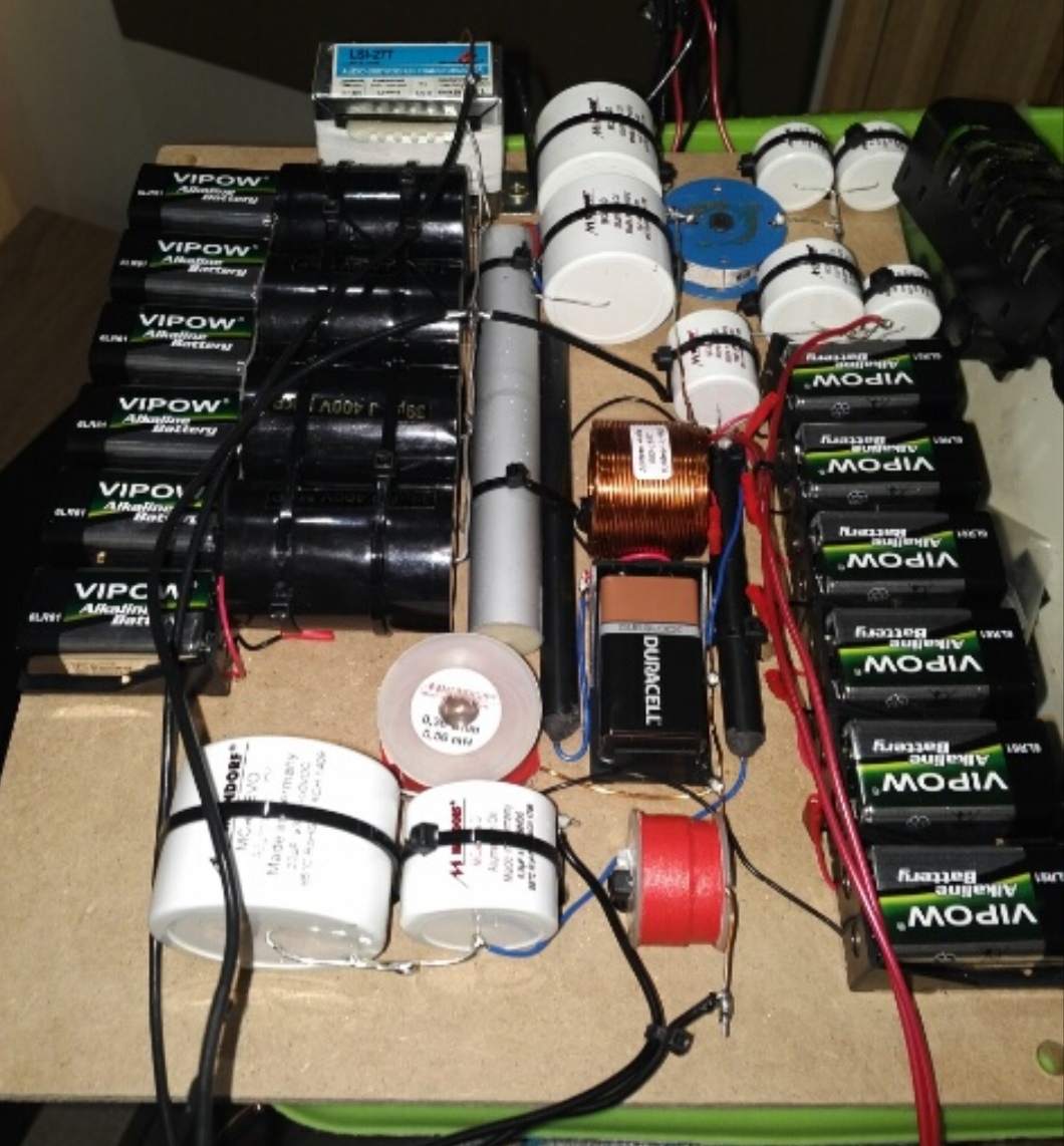

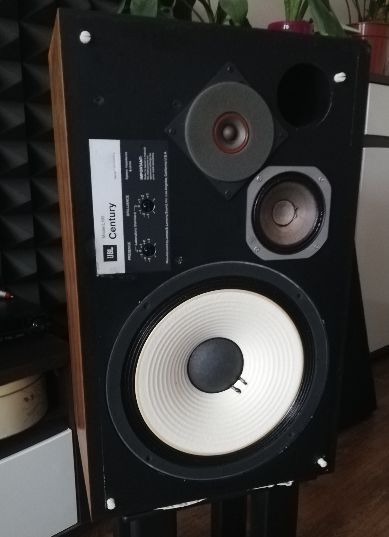

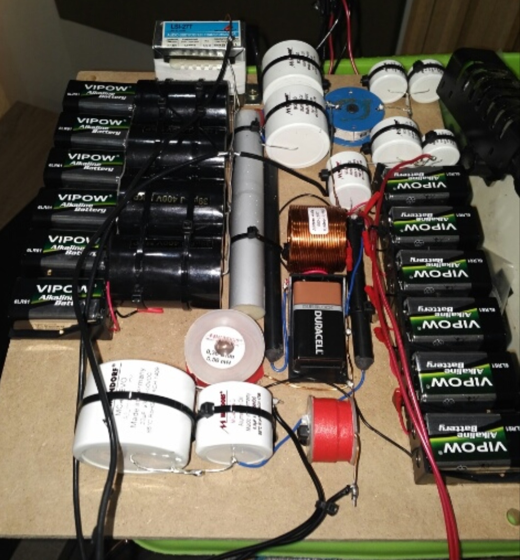

Some time ago I bought a jbl l100 century. I decided to improve the crossover according to Murphy's scheme. As I live in Europe, I used capacitors available at us such as mundorf Evo Oil, MKP, etc. I have slightly modified the design by adding battery power to each of the speakers. For high 1x 9V, medium and low 6x9V. From the very beginning of listening on the new crossover I was disturbed by too big bass. So I choked the bass refkex which gave very good results. Thank you, Swerd for inspiration. It was really worth it.

It would take a long time to write about it. I read once on one of the forums about powering the speakers with batteries. JBL has successfully applied this patent in some high models.
The JBL "charge-coupled circuit" replaces a single cap with a pair of series-connected caps of twice the value of the original single cap, the center-point between the cap-pair is attached to a battery in series with a 100K to 1M resistor, and the other side of the battery is attached to circuit ground. This polarizes both caps to the DC voltage of the battery, so the caps never go through zero-crossing. 9V is a better choice than 1.5V batteries, since loudspeaker-level signals fairly frequency pass through the 1.5V threshold, but 9V is getting pretty loud.
Building a new crossover I decided to try this patent. The effect exceeded my expectations.

Kapitan_Nemo, thanks for the photos of your work. Some of those capacitors are very large, larger than the inductor coils! And 13 batteries per speaker. That's one big crossover board.
I've seen this mentioned before, but I've never understood the reasons behind the design. Do you have a link that would explain this?
The new Murphy crossover requires 7 capacitors. The charge coupled modification can be very expensive because it requires twice as many capacitors all of which are double the origianl capacity.
How long do you expect those 9 volt batteries to last?
JBL did this years ago in some of its more expensive models, but I don't believe this charge coupled type of circuit is used in any new speakers. No other speaker maker, to my knowledge, has used this design.

To tell you the truth, I did not do it alone. I just follow news, interesting projects on the Internet and if I'm interested in something, I ask my friend to do the Task. This crossover was also done by my friend for me.
I will try to find links for you in a few days as I will have more time.
Capacitors are added only when there is one capacitor, because then if we would like to give a constant voltage it would go to the loudspeaker or amplifier, then we add condensers so as to maintain the required capacitance and the voltage between them will not go in any direction because the capacitor does not release voltage solid. There we have a 3rd order filter where there is a capacitor, coil and capacitor, so we have a capacitor on both sides that will block the DC voltage, and because the battery for the alternating current in the crossover is a short circuit, then supplying the battery to the coil between the capacitor gives us the DC bias effect condensers and the battery itself is a short circuit for alternating current, hence you can do it.
Therefore, additional, double-value capacitors were only added for the bass speaker and additionally a transformer coil.
The new Murphy crossover design, alone, can account for a much improved sound quality. Were you able to compare two L100s both with the new Murphy crossover, but one with charge coupled circuit, and the other without it?
No, I did not compare Murphy crossover without an extra battery. I was just fantasized and decided to check how it would work. So it is difficult for me to say what are the advantages of this solution.
I can only say that I have never heard such a resolving bass.
