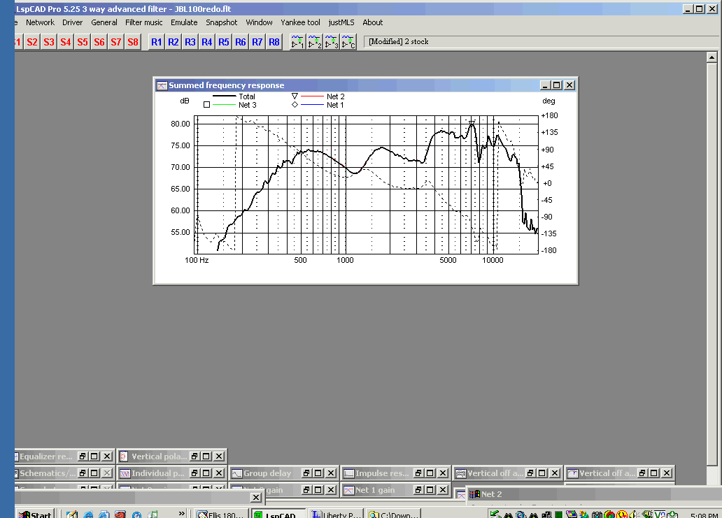

The original LE5-2 midrange drivers that I had were far from smooth sounding drivers. Here is their raw (unfiltered) frequency response. It took a lot of work before a good crossover design was developed. The volume adjustments from the variable L-pads cannot correct this lack of smooth sound. And that's if they are working. Most L-pads corrode and get noisy, or fail to work at all.
Once it gets reconed important things change. Often drivers also get new voice coils at the same time as reconing. Did yours? This more than likely changed most of the driver's Theile/Small parameters. There were also different versions of this driver produced over the years. It seems like your two mid ranges are essentially different drivers.
DC resistance (DCR) of a driver tells you very little useful information for crossover design. For a mid range driver in a 3-way speaker, you need to know the impedance and SPL across the audio range involved. And this is best measured while the driver is mounted in the intended cabinet. And it is probably better if both mid range drivers have similar performance.
