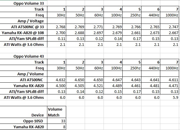

I just completed a 2-channel single-blind listening test of the Yamaha Aventage RX-A820 versus an AT522NC (NCore) amp 200 WPC. The A820 was in Pure Direct mode and both were driven from the analog outputs of the Oppo BDP-105D DAC/Player. The BDP-105 was providing volume control and the level were matched comparing the voltages with the Oppo at volume +33 (the scale is 0 to 100). The A820 was set to volume +8 to be within .2 DB.
I switched the outputs with friend and he for I and the difference was obvious even though at this volume driving the Revel M20 bookshelf speakers the power is usage is about 2 watts. The soundstage, separation, dynamics, bass, and treble were all better with the AT522NC amp direct. How much better? Enough for me :)
The entire signal chain is compared and there is an extra volume control and preamp function in the A820 but for this thread that is an appropriate comparison. It could be the A820 preamp or it could be its amps.
These bookshelf’s dip below 4 ohms and speakers are reactive loads there are no consistent measurements for a particular amps ability to remain linear.
The ATI522NC is not the pretest amp but it works very well. Idling and during these tests it used about 25 watts. For this two channel system, there is something elegant about the Oppo direct to amp. Perhaps, if Oppo beefed up the player a little with better bass management, they might still be with us.
Like any listening test, it means this room, these speakers, this amp and this AVR. Change anything and it may not apply. But it does mean that power is an important metric but not the only important metric.
If I can do this comparison, so can most here with the right gear. But, why on earth did I bother doing spending over 8 hours on it when I could just have googled the power ratings? :p

I just completed a 2-channel single-blind listening test of the Yamaha Aventage RX-A820 versus an AT522NC (NCore) amp 200 WPC. The A820 was in Pure Direct mode and both were driven from the analog outputs of the Oppo BDP-105D DAC/Player. The BDP-105 was providing volume control and the level were matched comparing the voltages with the Oppo at volume +33 (the scale is 0 to 100). The A820 was set to volume +8 to be withing <.2 DB.
So in this case, the ATI amp sounded better than a lower-price Yamaha 800-series AVR.
I've never listened to an avr at +8...or used one as a power amp. What was the detailed conclusion?
- Rich
Interesting test. Thanks for taking the time to share. What do you think made the difference?

The improvements found in the AT522NC are better defined highs so the symbols sound more extended and natural. Female vocals are clears with some fuzz removed. The bass seems deeper but not more. The sum total produces a better image with more depth and the instruments blend better. Add more clean power and control and even bookshelf speakers can sound better. Words to describe sound are limited ;)
Long term listening the system sounds enough better to make me want to listen in the game room again. I read the reviews of the Yamaha, specs and measurements and thought the Yamaha would be good enough. It's not.
The processors on my radar are the Emotiva RMC-1 and XMC-2 (or whatever its called) and the ATI ATP16 (although I don't need that many channels for my main system).
Emotiva’s new receiver is really interesting too. Balanced outs for the Fronts and Center and Class-D amps. Interesting times.
BTW, You need power for surrounds there is a lot more music from the rears and movies like Jumaji put a freightening amount of sound out of all channels. I thought my center was coming off the wall.
I do know @gene has measured some recent Yamaha AVRs and they didn't do well in the amp section. Particularly with 4ohm loads IIRC. Wonder if the difference you heard was as simple as that?
I can't be certain with the extra preamplification but I suspect that Yamaha is primarily concerned with product that never breaks. The current limiting circuitry may be over zelous or they it may have cut corners. When you switch it into 4 ohm mode, it sounds blah even at low power. More of what I don't like about it.
It may be that a Denon of the same power, would fare better.
