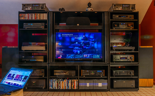

Buck,
I didn't see posts from you for a long while in this forum last year. This is why I presume that you didn't see photos of my 7 channel system which I posted last year.
Here they are:
https://forums.audioholics.com/forums/threads/my-7-channel-system.111234/

Buck,
Here they are:
Cheers,
wow. I give you two big thumbs up for your room and your equipment layout.
I love the reel to reel tape deck. I have often thought I would like to put one in my room, working or not, just for the cool factor of having one in there. I don't have a stitch of music on RTR, but, the cool factor of having one sitting in my music room may be something I have to find a way to do.
Thanks for sharing. I love looking at how the other half lives.
Terry

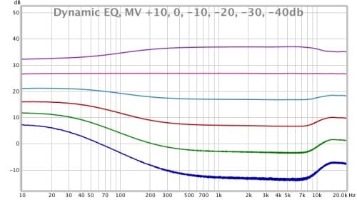

Yes. Both Music and Movies. Same results. Everything above bass frequencies are the same as Pure Direct. But bass is dramatically more impactful and dynamic with Dynamic EQ.
I must listen at loud levels since I don't hear a big difference at near reference volume (typically have volume at -8 to -4 range for movies and -10 for "most" music (it varies more in average level). Dynamic EQ does seem to help at lower volumes (a bit like the old 'loudness' buttons.
The closer to reference volume the less DEQ does...with some ability to adjust via reference level offset.
You're right. I think DEQ only boosts the heck out of the bass when the master volume is lower than -10.0. At high volume, it doesn't seem to boost the bass.
But when it's doing something, all it's really doing is boosting the heck out of the bass and boosting the treble a little bit.
Right now I'm using PEQ to boost the bass 20-80Hz for all volumes. Haha. :D
You are also right. Looks kinda like this.
