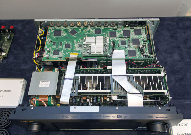

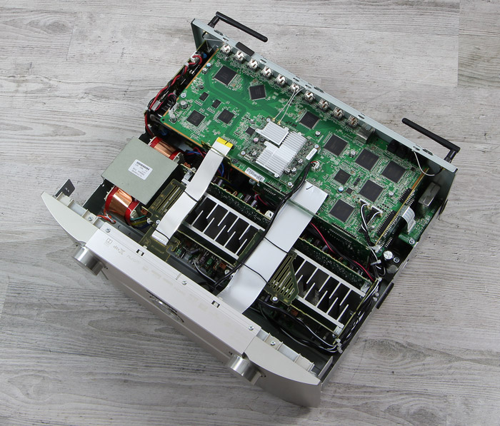

If less part is better (the @ADTG question) the Marantz HDAM thing is really silly. It is pretty obvious to me that they don't make any audible difference, and I am sure Marantz knows that too.
Look at the pictures below, they have virtually identical layout, yet Marantz has to find room to jam-packed (@ADTG's favorite:D) fit the 13 channel (so called 11.2 processing) audibly useless:D HDAM module in a box that is only slightly larger. Denon also has the audibly useless:DAL32, but at last that's done digitally so minimum heat contribution and don't take extra space.
