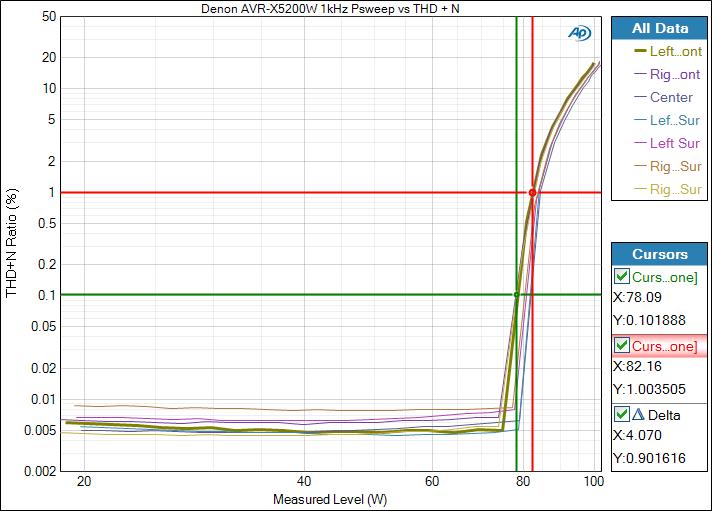

Not equivalent measurements. Source?
Audioholics.
I also wonder how much worse the AVRs graph would look (and how much worse it would sound) if you ran demanding speakers on it all day long and didn't have a few aftermarket fans on top cooling it off. Unless it's designed to run optimally at extremely high temperatures it's not going to sound better when it's overheating. Got any eggs to fry?
Denon AVR-X3300
Yamaha A-S801
PENG
They may be equivalently priced (with discounts), but the AVR is an AVR and that has more amp channels on top of the whole bunch additional AV features. That's why I would compare the price point of an integrated amp to that of an at least one model year older AVR to partially level the playing field. This is getting difficult too as the near flag ship AVR models are getting much more features and channels, widening the price gap between integrated amps and AVRs with similar output ratings of the yesteryear (but brand new)
For the time being, I would propose to compare the A-S801 with something in the Denon 4000 series, or the older 3000 series such as my AVR-3805. I also have an AVR-4308CI so I am very familiar with it, and I know I am 100% in pure direct one (you could be the exception:D though) cannot ID either my 3805 or 4308 and the A-S801 better than 60% of the time, in even a SBT.
Note that the 4308 performed equal or better in the 10-150W range, and it is only rated 140W.
I know it is not a good comparison because they were done in different labs, but you can look up similar graphs done in the S&V labs on a few integrated or even separate power amps easily and will see that the AVR-4308CI competes well in this criteria.
Like loudspeakers, we can't draw conclusions on how an amplifier would sound based on just one criteria, so my post is just to counter (meant in a friendly way) yours, and am not drawing any conclusions other than noting the apparent differences in these particular set of plots.
Yamaha A-S801 (rated @ 100 watts)
https://www.audioholics.com/amplifier-reviews/yamaha-a-s801-amplifier-review/yamaha-a-s801-measurements

I believe the 4308ci graph you posted is for one channel only but I get your point. I put up another set of graphs in post #61 that are clearer than those in post #58.

The S&V graphs are most likely for two channel driven as they typically seem to match up with the output figures given in text too, but as you observed, I don't know why they wouldn't show two traces but only the left channel. So my guess is that the two channels look almost identical and they pick the left just for consistency.
Below is pasted from that review:
This graph shows that the AVR-4308CI's left channel, from Multi input to speaker output with two channels driving 8-ohm loads, reached 0.1% distortion at 198.6 watts and 1% distortion at 218.9 watts. The distortion level remained at or below 0.002% across all power levels until it reached about 165 watts. Into 4 ohms, the amplifier reached 0.1% distortion at 298.0 watts and 1% distortion at 343.4 watts.
Read more at https://www.soundandvision.com/content/denon-avr-4308ci-av-receiver-measurements#8BCZScyKXLIAJ4YK.99

eargiant, you mentioned your 3803 again and that it was in good condition, so my question remains, have you really given it a fair shot at comparing with your integrated? I mean in terms of carefully level matching, using the same analog input source, same everything, pure/analog input direct, SBT etc. etc.. I have no experience with the 3803 but given that it was only one model year apart from the 3805 (no 3804 that I can recall), it is hard to believe it would sound audibly worse than the A-S801. It would likely not measure as good, and the internal DACs have lower specs, but THD+N <0.05% 20--20,000 Hz, damping factor >50 etc should get it well over the point of diminishing return.
The gap is now so huge that I would say there is no equivalent as such. If we can stretch the facts a little then the last year model X7200WA may be considered equivalent, but it is no longer current. The current Marantz SR7012 would be closer, but not quite to the 4308CI's level on the basics.
DENON AVR-5308CI
236W x 2Ch continuously into 8 ohms @ 1% THD
339W x 2Ch continuously into 4 ohms @ 1% THD
185W x 5Ch continuously into 8 ohms @ 1% THD
169W x 7Ch continuously into 8 ohms @ 1% THD
SNR = 110dBA with 2.83 volts into 8-ohm load 10 Hz - 24 kHz
DENON POA-A1HDCI AMPLIFIER
197W x 2Ch continuously into 8 ohms @ 1% THD
318W x 2Ch continuously into 4 ohms @ 1% THD
188W x 5Ch continuously into 8 ohms @ 1% THD
182W x 7Ch continuously into 8 ohms @ 1% THD
SNR = 114dBA with 2.83 volts into 8-ohm load 10 Hz - 24 kHz
Denon AVR-4308CI
219W x 2Ch continuously into 8 ohms @ 1% THD
343W x 2Ch continuously into 4 ohms @ 1% THD
174W x 5Ch continuously into 8 ohms @ 1% THD
150W x 7Ch continuously into 8 ohms @ 1% THD
Denon X7200
186W x 2Ch continuously into 8 ohms @ 1% THD
266W x 2Ch continuously into 4 ohms @ 1% THD
138W x 5Ch continuously into 8 ohms @ 1% THD
124W x 7Ch continuously into 8 ohms @ 1% THD
SNR = 108dBA with 2.83 volts into 8-ohm load 10 Hz - 24 kHz
