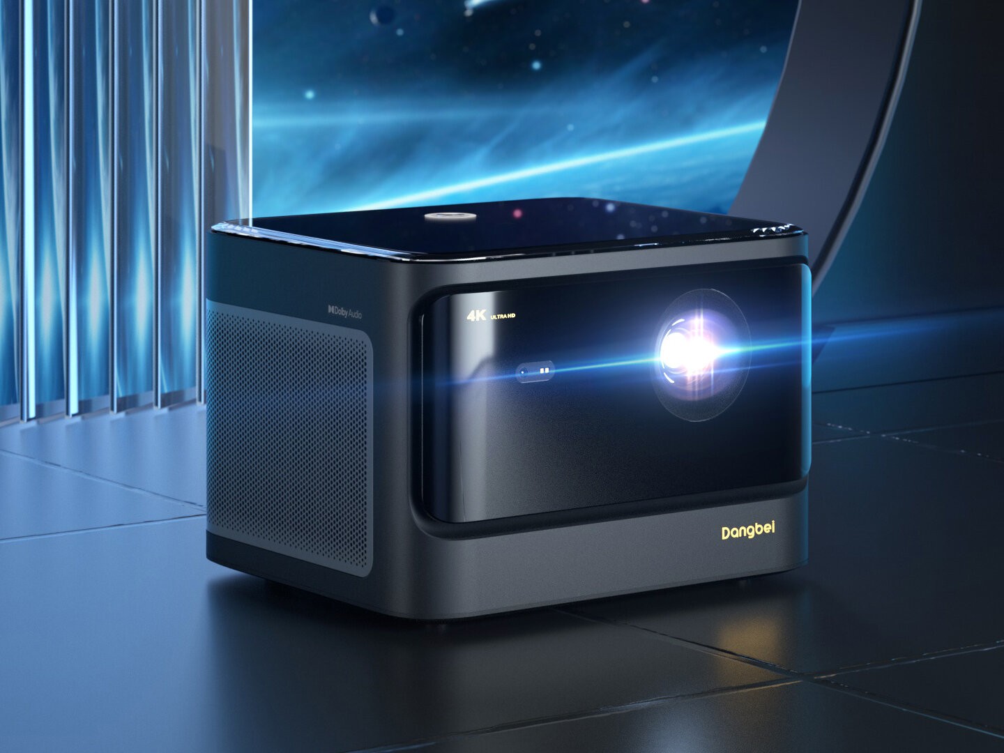

I got a question which is the lowest decent budget Native 4K projector with 3D available in 2023 under $700?
This looks like a nice compact one. Still a bit pricey:

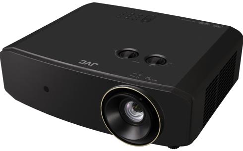

If only I'd win the lotto. :( :)
New JVC...

Keep in mind that is DLP. It uses the same DLP chip and light engine that ALL the other DLP projectors are using at this time. It is unlikely to be much, if any, better than the forthcoming BenQ HT4050i, which is a DLP model everyone should be keeping an eye out for.
The reality is that grey screens don't give you good blacks.
Grey screens are used to lower the brightness of a projector globally. So, if you have a .8 gain grey screen, you get a 20% reduction in brightness across the board. Yes, your blacks are 20% blacker... But, your whites are 20% dimmer as well. In photos, this appears as higher saturation, but it often is the same type of adjustment which can be made by properly calibrating the projector for best image quality.
The simple reality is that projectors which actually deliver great black levels from the start, are the ones which will give you the best image on screen. Unfortunately, it's extremely difficult to get a bright, really high contrast, projector. As the maximum light capability goes up, it scatters light inside the optical block of the projector, and black levels go way up. There is a solution to help with this problem, and that's by using larger imaging chips in the projector. But, that requires a larger projector and much more expensive lenses to make it all work.
At the end of the day, it's been proven time and time again that the LCoS offerings from JVC and Sony outperform the best LCD technology (Epson) and pretty much anything from DLP.
I would struggle still not to consider the Epson 5050UB as one of the best projectors for the money out there today.
