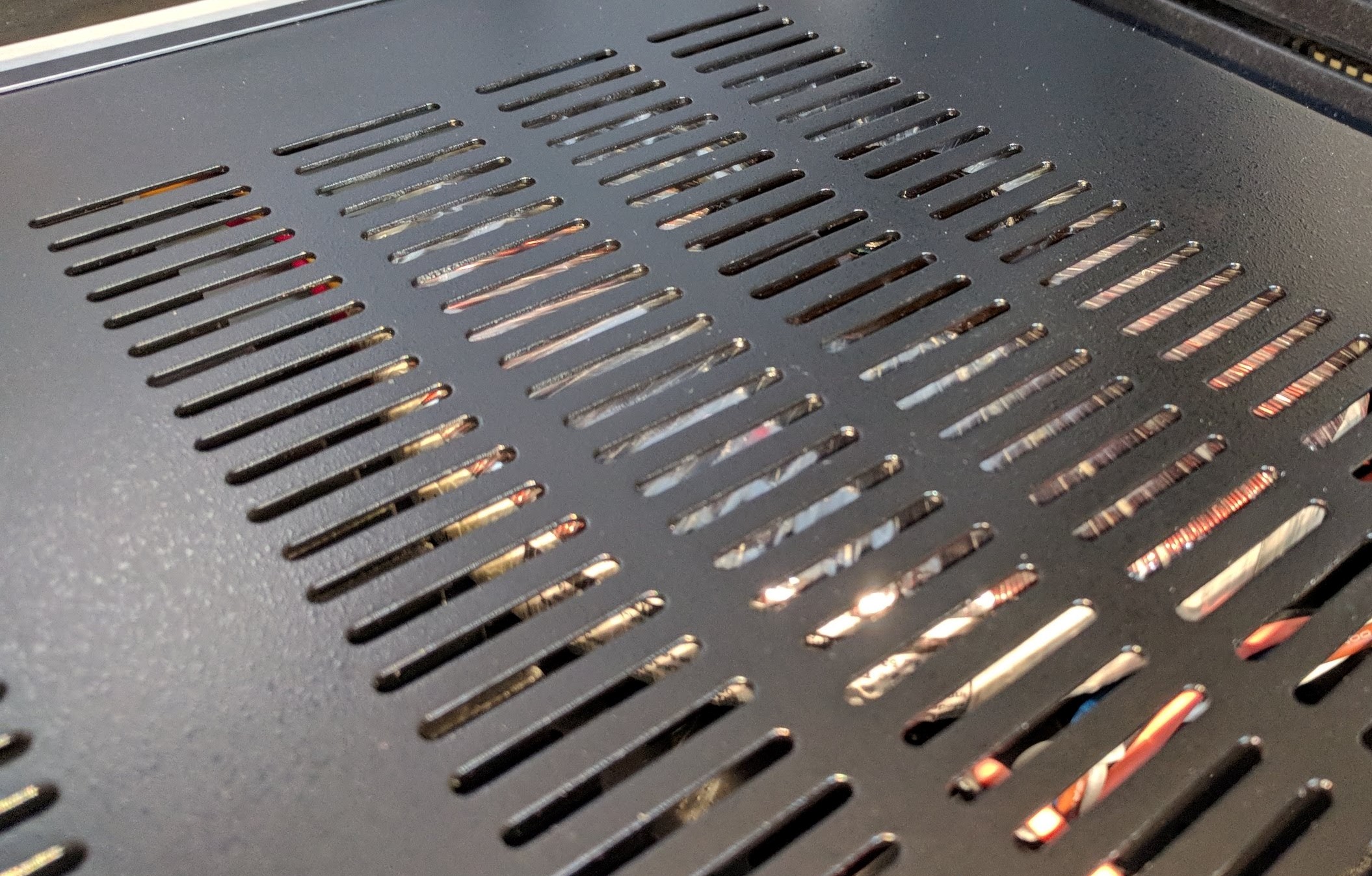

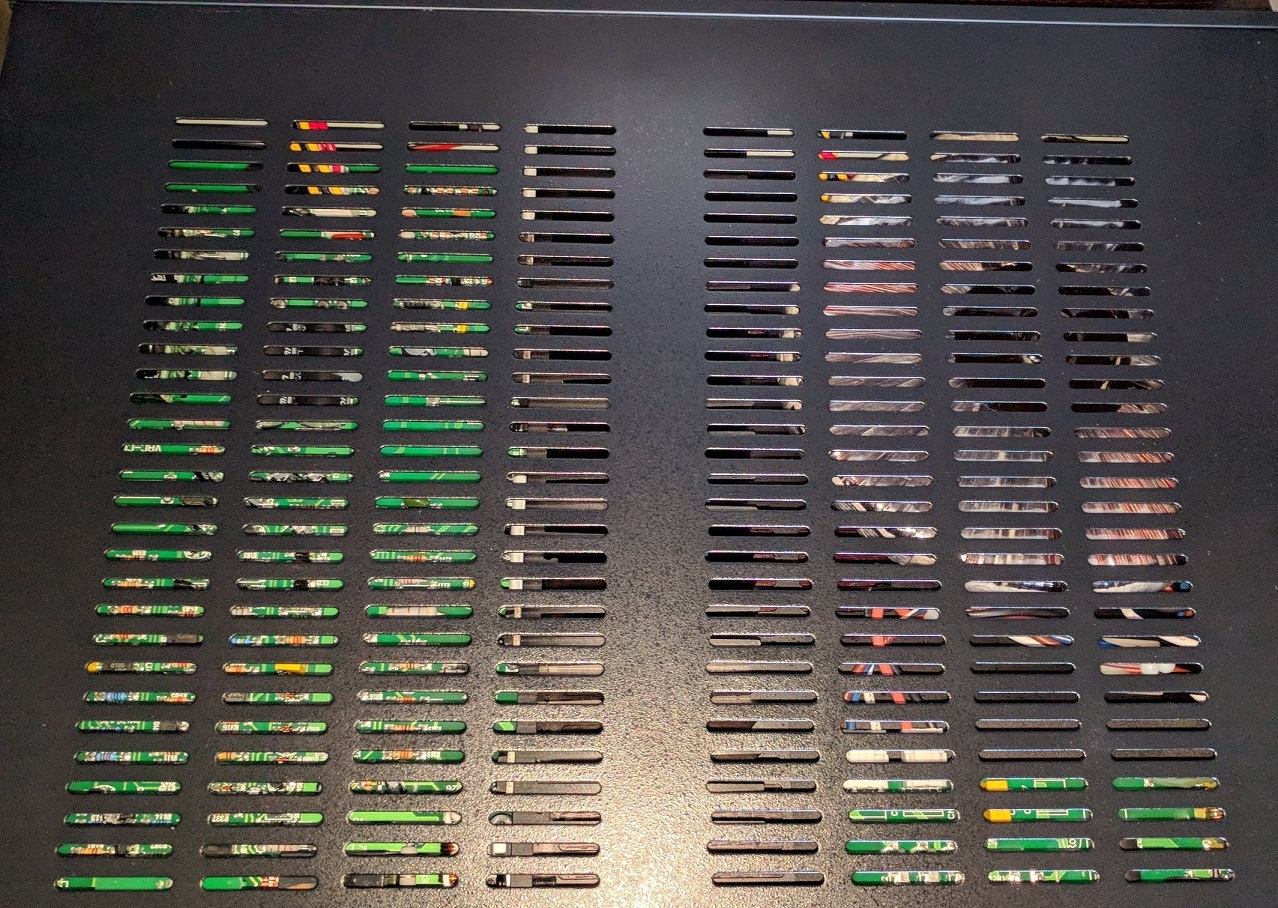

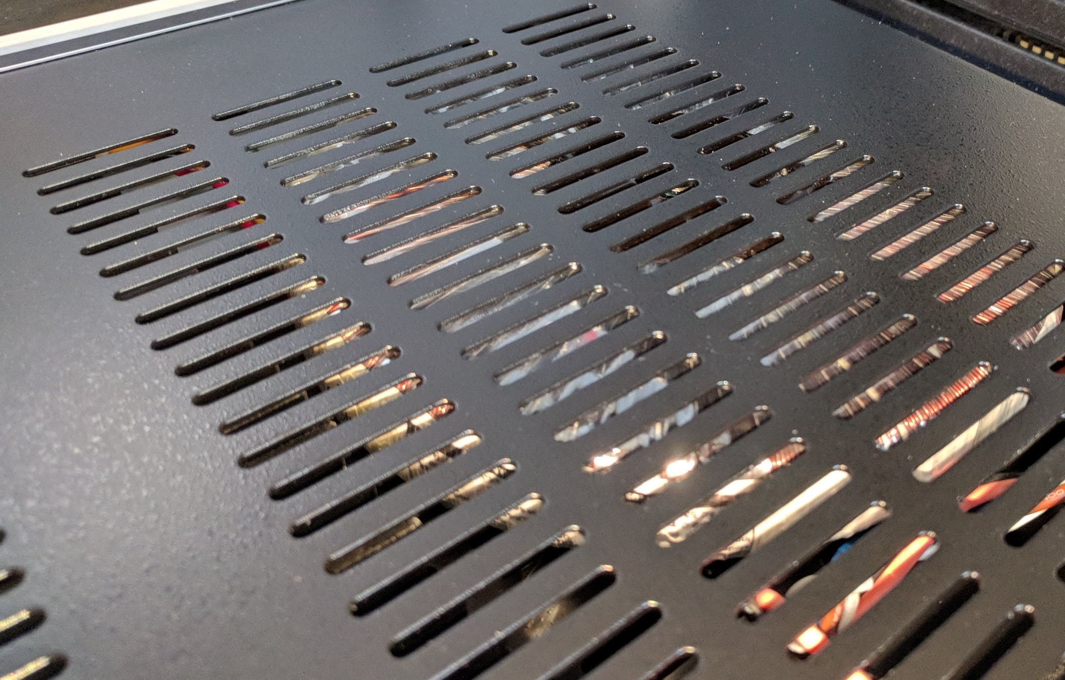

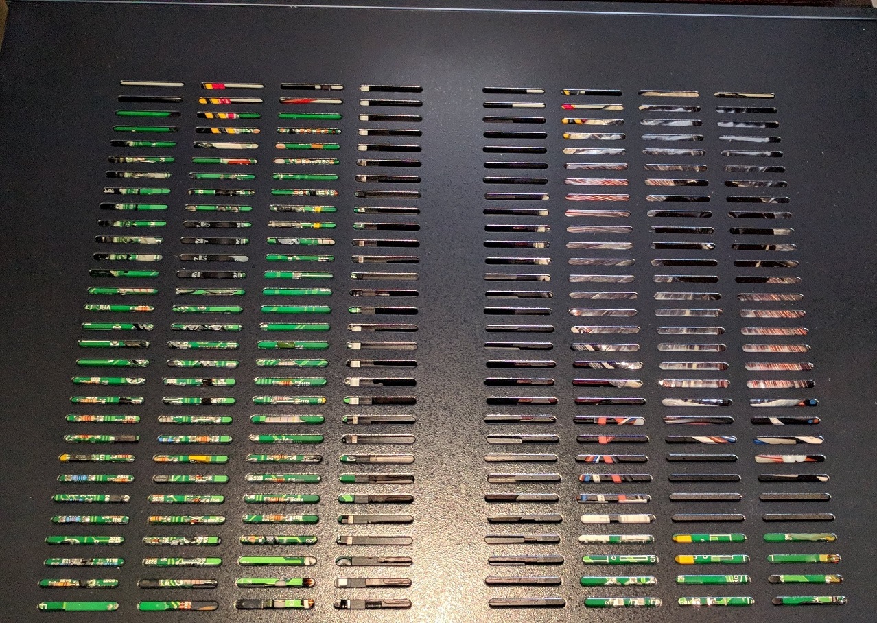

Obviously thin, but gigantic. I suspect it is rated about 350 to 400 VA.
