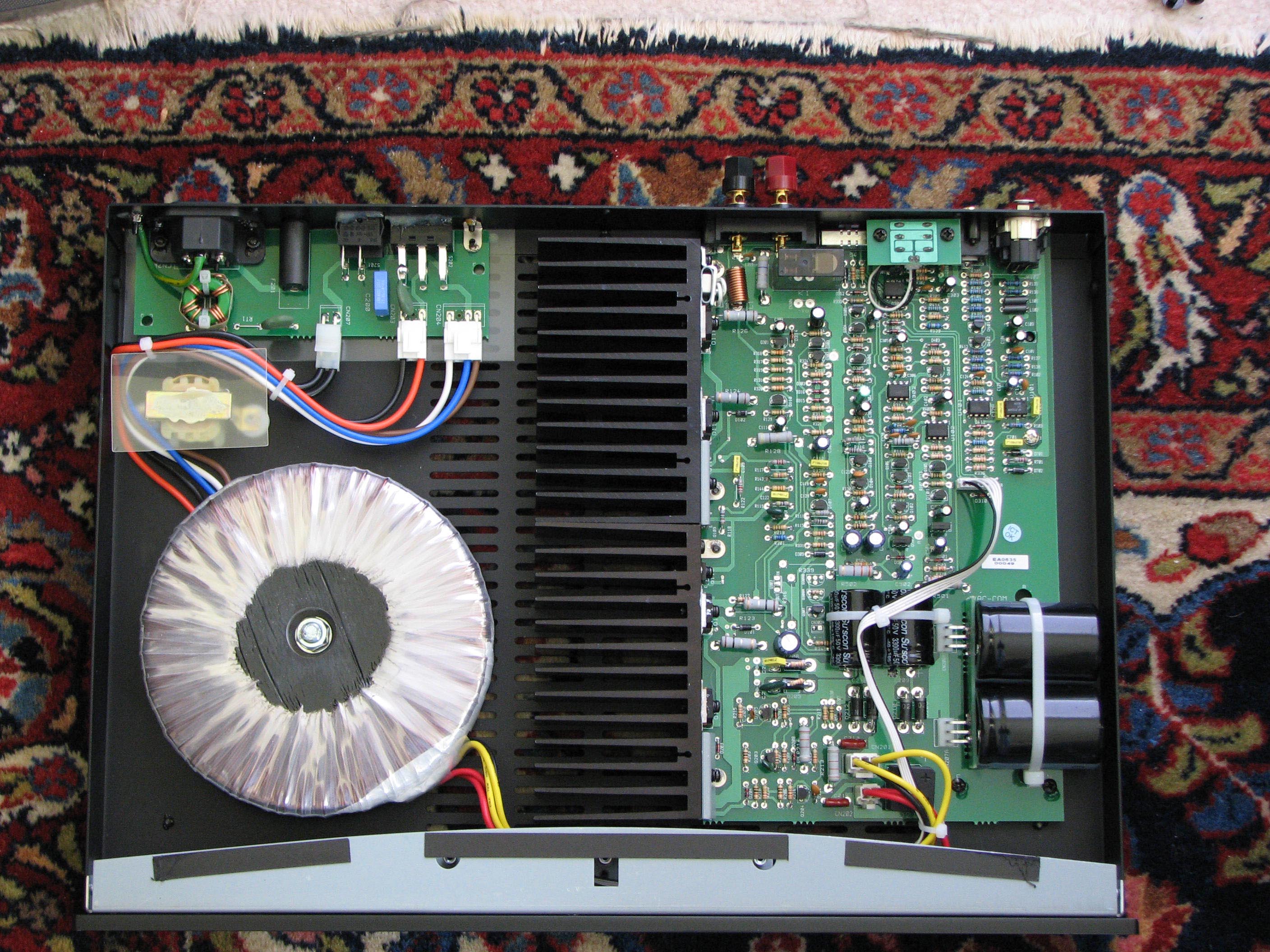

That hughe skinny toroidal pan cake must be custom wound for Outlaw right?:D:D I have many quite a few amps, all but one have toroidals, but none as big (of course in diameter only) as the one in the M2200, not even close.
Thought I'd add a pic that gives a sense of scale for the transformer. The M2200 is the standard 17" wide (actually measures 17-1/8") and you can see that the transformer is over 6" diameter (I'd guesstimate about 6.5").
