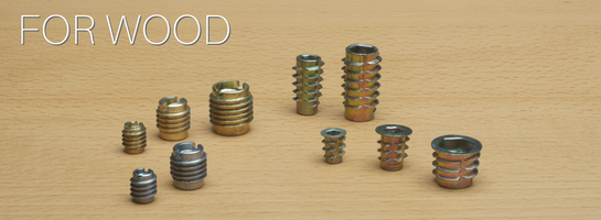

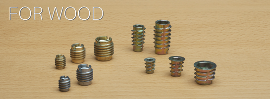

I have a couple of thoughts about securing speaker cabinets to stands. First, the weight of any speaker is not distributed evenly throughout the cabinet. Most of the cabinet is hollow. The driver's magnets will be center of gravity. In the BMR, the woofer has a heavy magnet, the mid-range is relatively small and light, and the ribbon tweeter has heavy transformer. All this weight is near the front of the cabinet. If your stand with a 8½"×6" plate is smaller than the BMR cabinet, it's alright if the hollow rear of the cabinet hangs over the edge of the plate, as long as the speaker's center of gravity is on the plate.
Second, wood screws through the plate into the bottom of the cabinet do work. Make sure the screws are shorter than the thickness of the cabinet. If the cabinet is ¾" thick, use ½" long wood screws.
If you want to do some worthwhile extra effort, use threaded inserts in the bottom of the cabinet. Use the kind of insert meant for soft wood (on the right side in the photo), not hard wood (on the left), and use an insert shorter than the cabinet thickness, such as ½" long. EZLOK is a brand name I remember, but there are others. They come in a variety of lengths and thread sizes. For most speakers, I'd use a #10 thread insert that's ½" long. If you pre-drill a starter hole the same size as the tip of the insert, they go in easily with a hex driver or Allen wrench. The result is clean looking, and the threads never wear out.
All sand absorbs moisture from the air. Kiln dried sand is alright, but still absorbs water over time. To prevent rusting the stand's steel tubes, put the sand loosely in several plastic bags before putting the bags into the hollow tubes.
Mr._Clark
I'll second the inserts designed for soft wood. I used EZ Lok inserts (bought on Amazon) to mount a pair of surround speakers recently and they worked very well.
