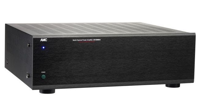

I think these are the ones he is talking about Lovin hoping to confirm with him that I have the right brand

If that's the right amp then it's 4ohm stable and puts out 140 watts into 4 ohms. Those M&K are 92 dB efficient and they are designed to use with a subwoofer so anything under 80hz the amp doesn't have to drive so I think the amp you have should work just fine for driving those speakers
Yup!
Thats the one.
I think they're meant to be 240w into 4ohm? The 3 channel one I have is 150w into 8 ohms.
There's 2 different ones
5ch 100w into 8 ohms
And a high current 3 and 2 channel which are 150w into 8 ohms.

Oh okay so they have a higher power option which you already have. Yeah since your crossing those M&K over at 80hz that amplifier is going to be just perfect for your needs Id just use the preouts then. That way you don't have to even worry about that protection mode being activated.

Thanks for the link, just hadn't run into these amps before. Would love to see some 3rd party bench tests, know of any?
The amp ratings are more peak oriented than continuous fwiw (the 150wpc/8ohm and 240wpc/4 ohm are based on a 1khz rating at clipping, clipping presumably being 1% but not stated particularly), so just a bit different depending what ratings you're comparing to. Not all that different from the RZ50's on-board amps but offloading the power supply needs of the avr would likely still be beneficial using the external amp.
Thanks for that.
A lot of that stuff goes over my head.
So essentially it's not a great power amp and probably doesn't drive my speakers much better than an avr apart from taking some stress off the avr itself?
I dont know any third party resting. There's not a lot of info out there on them, unfortunately.

"150 Watts True RMS Power per Channel, with 240Watts RMS Power per Channel at 4 Ohm Driven"
Such wording just don't inspire confidence, and if you look into the instruction manual, there is no 4 ohm power output rating, it just says 150 W (IMF) 8 ohm, clipping power 160 W 8 ohm
Why reference "IMF", that seems like a term/standard, rarely used in specifying power amp outputs these days?
They also claim "oversized" transformer, but there is no evidence of that if you look at the size of it in the picture.
