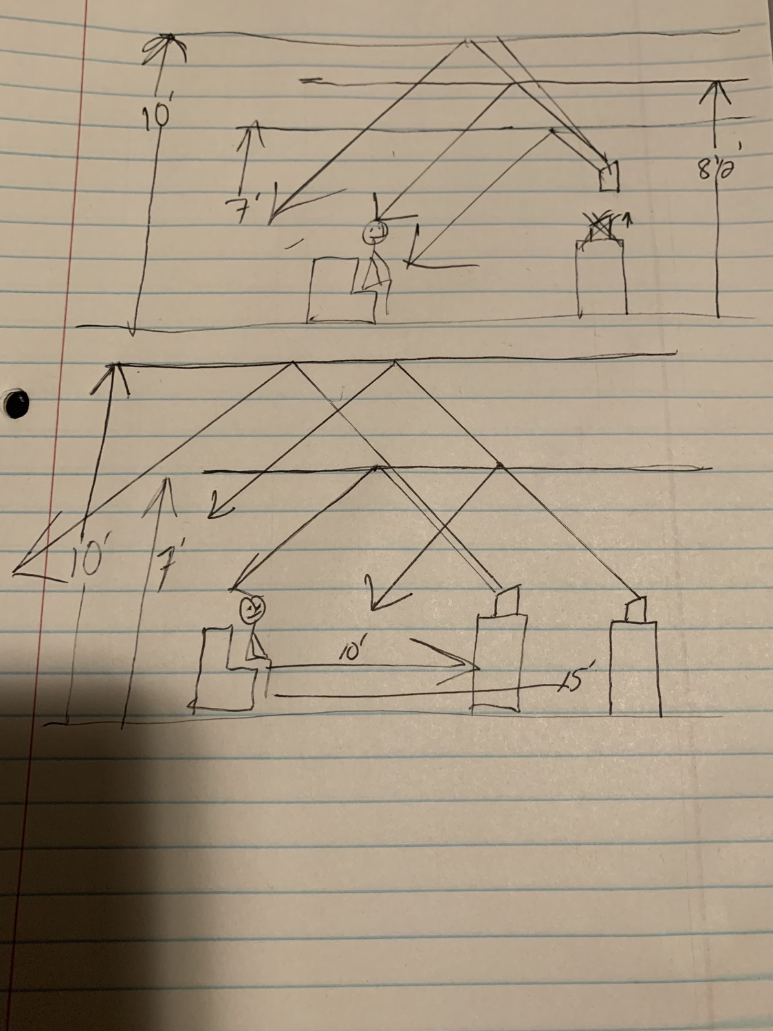

Are you saying that my surround sound placement being too high will interfer with the Atmos modules? I don't have a lot of room for moving the couch forward. Thats why the surrounds are angled down towards the listener position.
Yep. The more angular separation between the bed layer and height layer the better. Otherwise it’s all on the same plane, and that won’t work. Atmos uses the difference in height to phantom image sounds into the room, and just like LR speakers that are too close together, it won’t work. I’m going by memory, so a pic would sure help my little brain cell! Lol
Iirc you have 3 across the back? The one on the back wall should be removed(Atmos also only works in pairs so a single rear is out) and then just use a 5ch bed. Nothing wrong with that at all. Back when I had 5.3 I had imaging behind me all the time.
Another thing is placement of the modules. Ime you can’t just plop them on your mains and call it good. You MIGHT get lucky, but more than likely you’ll have to experiment by tipping them foreword or backward as your basically making a bank shot like on a pool table. Hoping it hits the ceiling and lands on the couch. Ceiling height is important too. This picture is just to give a kind of idea how placing the modules at different heights vs different ceiling heights can change the effect. It would be simpler to angle them up/down but I haven’t doodled that out yet lol
Hmmm it would only be 6.1.2 so I still maybe able to keep the back speaker but I would consider lowering all of the back speakers...My ceiling is about7' + but definately not 8".. I'm beginning to think that this room might be too small to go with Atmos... but.. just thinking about this.. I could mount the atmos modules on the wall behind my towers...The closet edge of the tower to the wall is approximtaley 20" - 24"
Nah, not too small. Just a little fussy. The rear speaker has to go since Atmos only works with pairs and that should help make it easier. Also, it looks like it might be more of a distraction than anything but I’d want to hear it before I could say that.
As far as the front wall goes, you should definitely experiment with the modules. Very room is different and you just have to find the right geometry.
For in ceiling though, imo a fish tape and a couple holes and you’re done. Unless you have insulation which I doubt.(and the top plate might be a problem, but a couple access holes to be patched later could fix that)) Finish the wall with terminals and plates and done!
Many IC speakers will work and don’t have to match the bed layer(although it never hurts). Iirc, Polk speakers tend to share sonic characteristics with some psb lines. You can get a pair of Polk RC80i for about 150 and others for less. Ypao will probably help match them up. To me that makes more sense than 700 for a pair of bank shot speakers. He’ll, you can get a nice set of mains for that! lol
