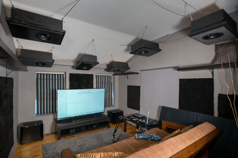

(Shakes head).  Please consider your own advice.  That's sad talking to that poor guy like that.  It's not easy trying to convey things when Dolby made it sound like their layout is completely incompatible with Auro-3D (and they could have easily made it fully compatible with a few extra rendering locations in their rendering processor, but they WANTED to be arseholes and WANTED to ban everyone else from using anything they do as well until the European Court system stopped them cold.  I can't say I'm too happy with their BS.   Height speakers work fine with both.  If the room is too long, it needs some top middle bridge speakers (they can be MATRIXED even and work fine; they just need to give a hard location so the imaging stretches past 120 degrees).  The speakers don't need to be "in ceiling" even at 45/-45.   They can be ON CEILING (much easier to set up; I'd use flat wires if you can't get it up in the ceiling).  Just mount something like a PSB  CS500 to a joist and it's aimable as well.  My system works with everything perfectly fine and I'm using bookshelf, side height plus an on ceiling combination.  The drivers don't know how they're mounted.  They just blend together....
BTW, most (really ALL) of the Sony SDDS 8-speaker locations ARE also Dolby Atmos locations if you have a Trinnov processor so with one of those you could do play Atmos movies using the same layout (or more).  I have a DSX (Marantz 7010) AVR here. I hated it.  The extra reverb was fake/echoey sounding to my ears.
