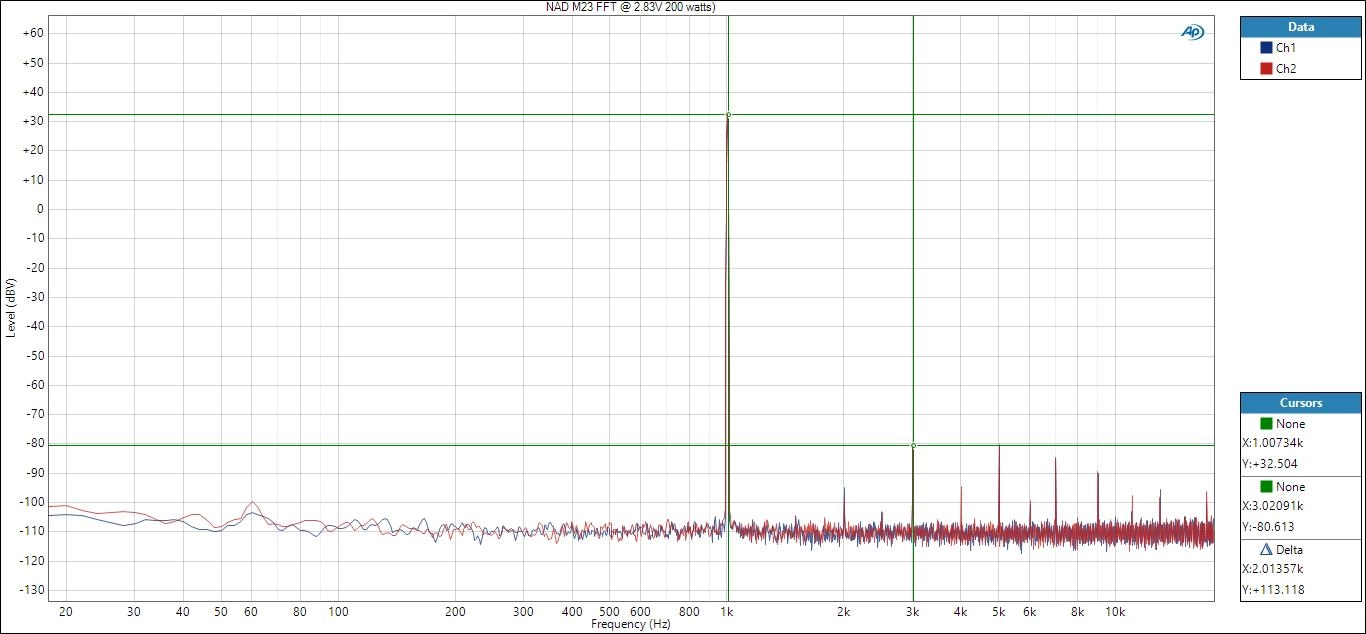

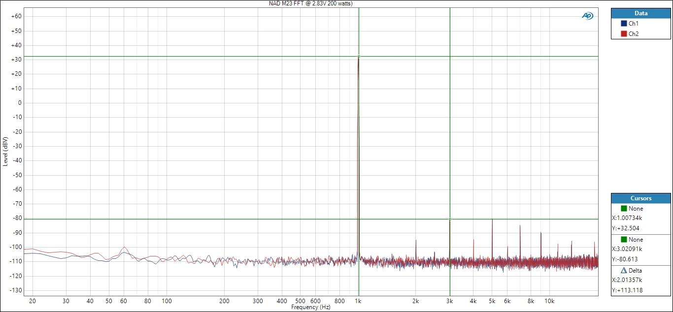

Hello Gene,
Everyone seemed to do the FFT (as shown below) with 1 kHz signal, if you still have the unit or if not would you do it in your next one, using a higher frequency such as 3,500 Hz.
I know it won't likely differ by much as can be seen in the frequency dependent test, but you never know. At 3,500 Hz, that is mostly in the range of most tweeters so I am curious to know what the FFT would show, in terms of the 2nd through 7 th harmonics contents (24,500 Hz). I do expect them to be slightly higher than those shown in the 1 kHz test.

Hello Gene,
They will be higher for sure, especially since the feedback of this amp is optimized for 20kHz and below. It's not a standard test to do an FFT up at that frequency but I will look next time I do bench tests.
