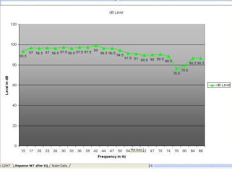

Here is my updated room response after the DCX implementation.
It is more "house curve" than flat response, but overall it sounds great. I do have a dip in response to correct though and possibly a bit of phase correction, but overall it works very very well. The results speak for themselves.
I need to add 2db more cut at 42hz though and I will be +/-1.0db from 17hz-48hz or so. I just need to tweak the upper bass response then.
FYI from these levels, I have 20 more clicks on the volume control before I get anywhere close to limits. :D
I may "burp" the sub at 20hz near full output to see what type of output it is capable of. My guess is around 115db+ in my room. I need to make sure the neighbors are out though.

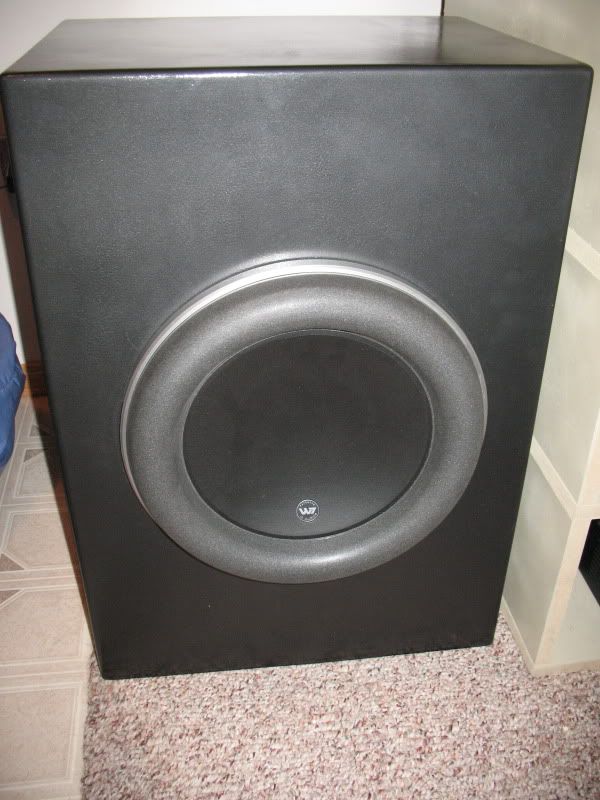

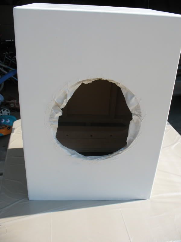

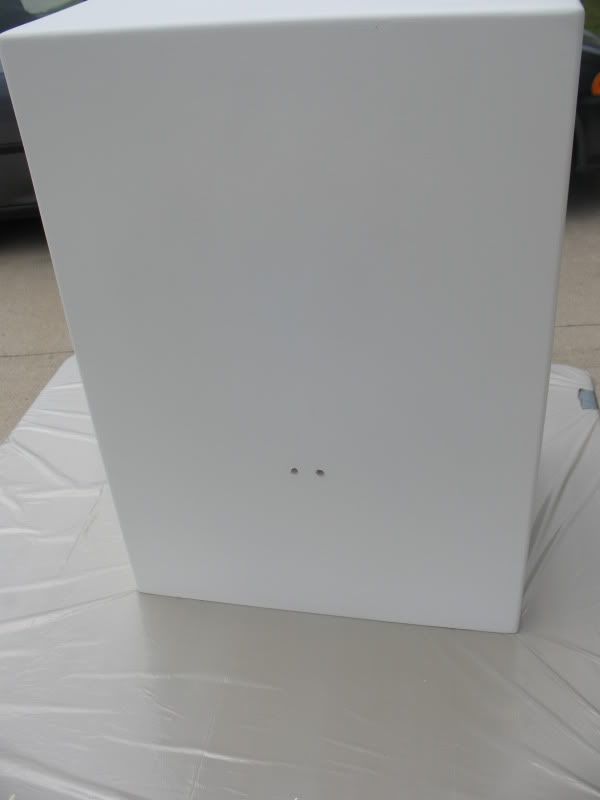

I finally took this enclosure & refinished it.
Sanding off the carpet glue was a pain, but I got it done and I am happy with the results. I used a hammered black finish and it turned out really nice. It looks quite good, even up close. I routered all of the edges with a 1/4" roundover.
Here are some steps of the process:
Enclosure Primed:
Binding post holes drilled:
Finished result:
I will let everyone know how it sounds after I get everything else installed sometime this week. I did some very limited (time and wattage) initial listening and so far it is great, very detailed and transparent.

Could that dip be a room mode or at the crossover point?
The dip is near the x-over point which I have addressed some and response is a bit better now in that area.
Describing bass response is not always easy. :D Realistic can be described a reproducing a live event. The sub does the best at this that Ive heard to date. (stand up bass, plucked bass, low tuned kick drums, etc.)
