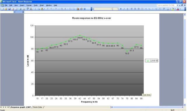

I got the DCX2496 up and running. Oh what a fun toy!!!! :D
I love it. Based upon my pre-eq modeling, and applying the correct amounts of eq with the correct q factors, I should be (I have not re-measured for the sake of the neighbors, they've been home) near ruler flat from 16hz-80hz in-room. Thankfully my room only had one mode (due to good placement ;) ) at 42hz at the listening position.
Here is a screen shot of my room response pre-DCX:
