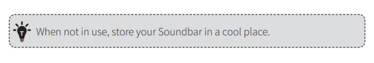

Hmm, this is the only useful piece of information I could find in the user's manual:

:D:D
I feel for them. I think that's the only one they sold!
