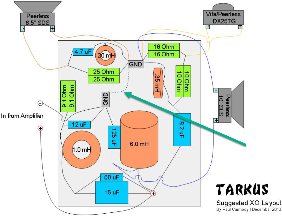

I have one other question though. On the colored suggested layout, there is a hyphenated line going from one ground to the other. I don't get what the dotted line means unless it has something to do with the reverse polarity on the other drivers. It's been a number of years but I thought that type of line used to mean shielded cable or something.
I checked his notes and there's no mention of the intent of the dashed line. (See Green Arrow) I've always used dashed lines in wiring diagrams to show an option on a circuit, but I've always thought crossovers are typically just wired one way. The change in polarity of a driver is accommodated in the circuit design. Note how the + terminals of the 6.5" SDS and the DX25TG both attached to the upper GND Block while the - terminal of the 10" SLS does the same which effectively reverses it's polarity compared to the other two drivers. On the schematic the orientation of drivers is shown below their names. (look for a + or a - _

I'd have to redraw the schematic from the layout drawing to see for certain as I can't visualize it from the picture on my monitor. (My wife says I've never been good at visualizing things.) Maybe another member can. If not I'll try to make some time tomorrow and figure it out.
I added the wire between there anyway. Didn't see what it would hurt with them both labeled ground without any other special notes on the crossover. I mean why bother to leave a trace there is there is to be no connection. Wonder if it means twisted cable, perhaps. I don't see why it would need that though unless it's for how many components share that ground point to make a more robust connection to add redundancy or something.

I don’t know why it’s dashed, but the connection of that common ground to the other is necessary as there is no other connection back to the amplifier without… unless some other wiring change is made.
In some manner it seams he could have slightly redid the layout to accommodate a single hounding point as the are so close… or perhaps just the inclusion of a solder tag strip could have helped to connect everything. :)
