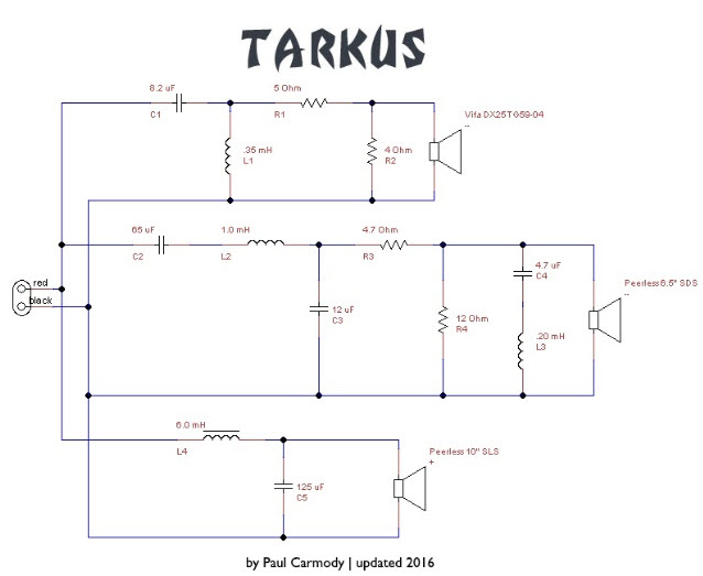

I think I goofed. I am partially blind and cannot read the schematics values on the Tarkus page. Plus there is schematics for two variations of the tweeter. What I ended up doing was ordered parts from the colored, suggested layout for the parts. If the values are different, than that confuses the suggested layout too. The larger I blow it up, the blurrier the numbers get.
If anyone with a sense for this stuff and a decent pair of eyes can tell me the difference. I haven't assembled anything with the crossovers yet but if the colored layout is way off, I have a bunch of parts to add to my extra parts box.
ETA: I found some additional resistors I had ordered that seem to coincide with the revised crossover. It has just been a couple years since reasoning all this out, or forgetting if I had actually done so when I ordered the parts. Will have to check the caps again.
Which tweeter do you have? The G09 or G59?
I'll try to assist.
The tweeter has changed from DX25TG09 to DX25TG59. The diagam above is for the new part number which is DX25TG59-04. Your order would have been for it.
If this diagram is still too small, just advise and I'll bring it into an editing program and increase the Font Size of the components.

What also confused me is I forgot to divide the doubled up resistors and took the R at face value so that made me think I really missed something.

The only change I see is that for the G59, R2 is 4ohm value... If you had the older tweeter it is an 8 ohm value.
But as best I can tell, you are solid.
There were no other differences in the schematics that I saw. :) I think my eyes are still seeing. ;)

Yeah, that brown text goes to hell for me if I try and blow it up.
Thanks for the help. . .It looks like I got the wrong inductors too. if those are all different from the original as well.,
Is the colored diagram the same except for the 4 ohm? That explains the 4, 8Ohm resistors I have 'extra' because paired like the colored diagram shows (I assumed they were paired for heat?) they would equal 4 ohms.
The only difference I noted was the last Resistor (R2) value shunting the Tweeter... everything else is identical.

Krikey.
OK, I see...
He did not update the "layout diagram." He only updated the schematic. So the Layout Diagram you used was for the old tweeter.
I can't speak to why he doubled up all the resistors... but it is consistent.
So that would mean the two 16 ohm resistors should be changed to two 8 ohm resistors for your newer Tweeter model G-59-04.
Correct?
What also happened in the middle of all this is some parts were backordered without a known update and I had parts trickling in for 2 months. Just found 4, 4Ohm Zistors. Someone was out and the only way I could get 4 ohms with parts available was with the zistors but those got lost in shipping and magically appeared 3 months after. It's all coming back to me now.

Krikey.
OK, I see...
Correct?
Correct.
I think they double them up like that for heat tolerance possibly for the fact that these might get driven hard. I think they do that so they don;t have to buy the heat sinked Zistors.
So you should just be able to use the single 4ohm Zistor in that spot, ya?

You guys are a life saver, on NY's eve no less. I much appreciate the quick response. My eyes were watering from trying to see that. Been welding 30 years.
MrBoat
Dual 16s out, 4Ohm zistor in their place. :)
